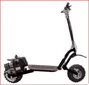

Nice beastly build as usual Low........here's the trail ripper that you mentioned earlier......
They go pretty well with the CY 46cc engine but they are not cheap.
Scotto,
Yeah I've priced them & they are silly priced (over 1K).
