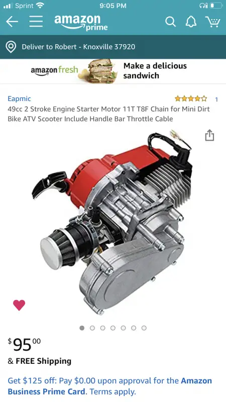

Namely this one with the gear box, it’s small, but I’m curios about it’s power output and if anyone has a pic of one in a real world setting.
I want to use one on my old mini bike I’m rebuilding for my lil boy because a Briggs style motor just isn’t reliable enough for my taste and I want something different for him that will be easier to start

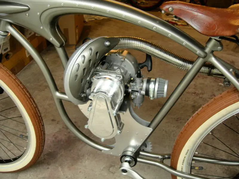

Just another awesome build by PeteMcp !! I had one of those conversions and wired to fish eye leds looked amazing....like you builds.

I'm using one on a Schwinn. FWIW the pocket bike guys tell me they're designed for 1.9hp.

A new 1 piece top end's only $25. There's a "big bore kit" out there that really isn't because it has the same size 44mm piston for $50, but at least its a 2 piece jug.
They do need a flat motor mount which would useful in a Briggs style mini bike. Where you put the holes will determine chain alignment so I'd be real careful about that.
The output sprocket on that gearbox is probably 8mm chain. 14T is common but other sizes are available.

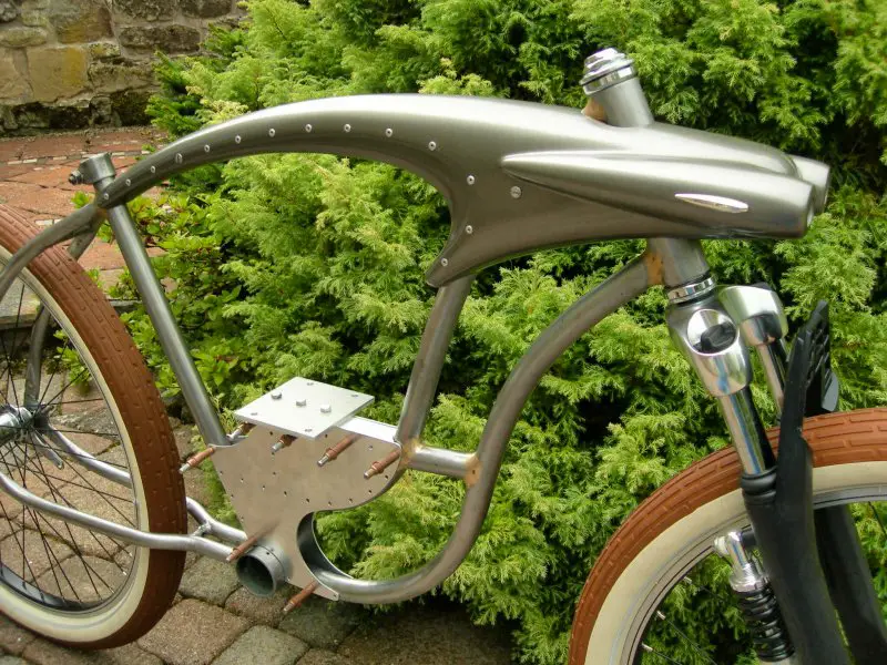

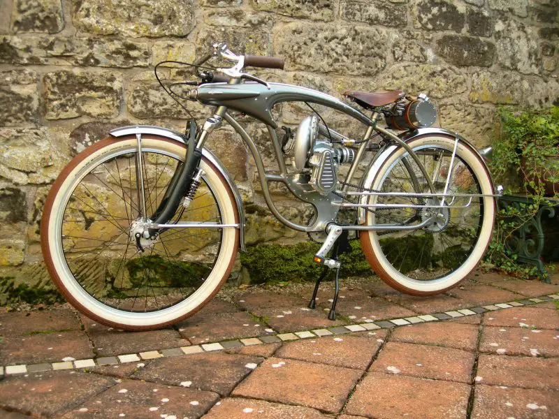

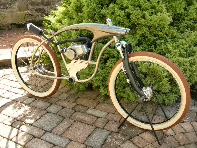

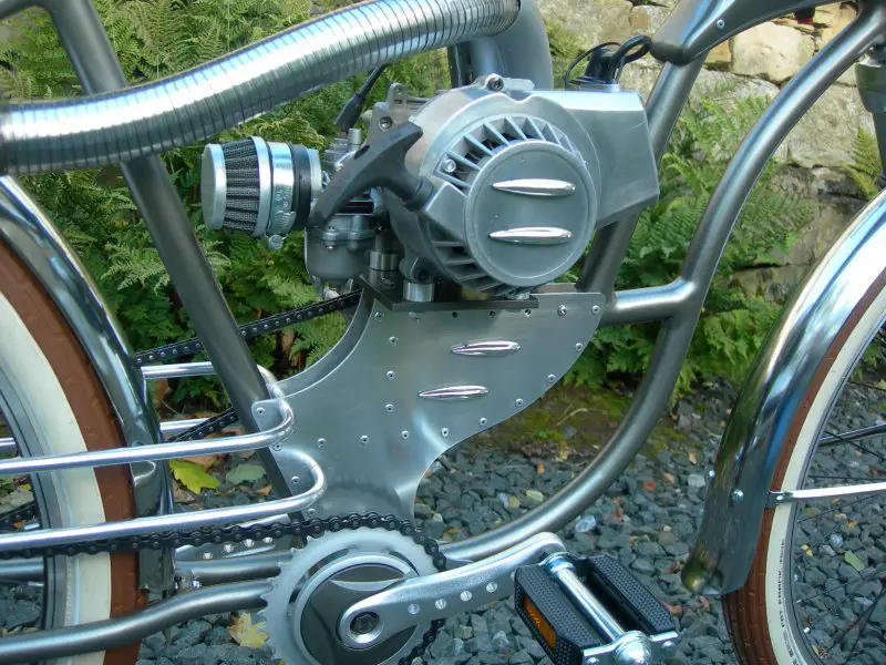

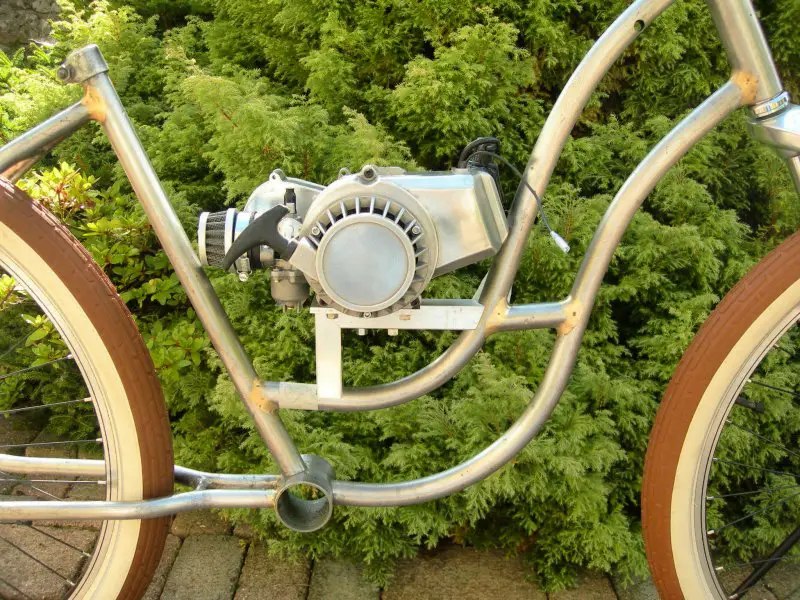

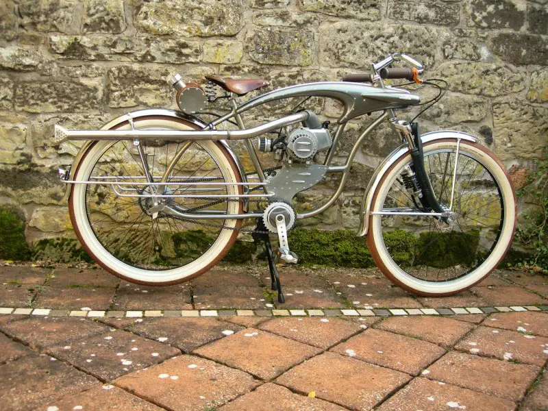

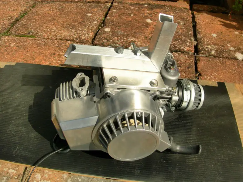

These motors aren't really 'pit bike' engines. They're from Mini Motos and as such, I found very little available in the way of exhausts, other than the 'standard' type, when I was building my DECOLINER. An eBay search for Mini Moto exhaust/muffler should show what's out there. Nearly all feature the chamber under the engine, which wouldn't have worked for my particular application. They aren't expensive. I purchased the one shown in this pic and greatly modified it as described in the bike's build thread to fit my requirements.
