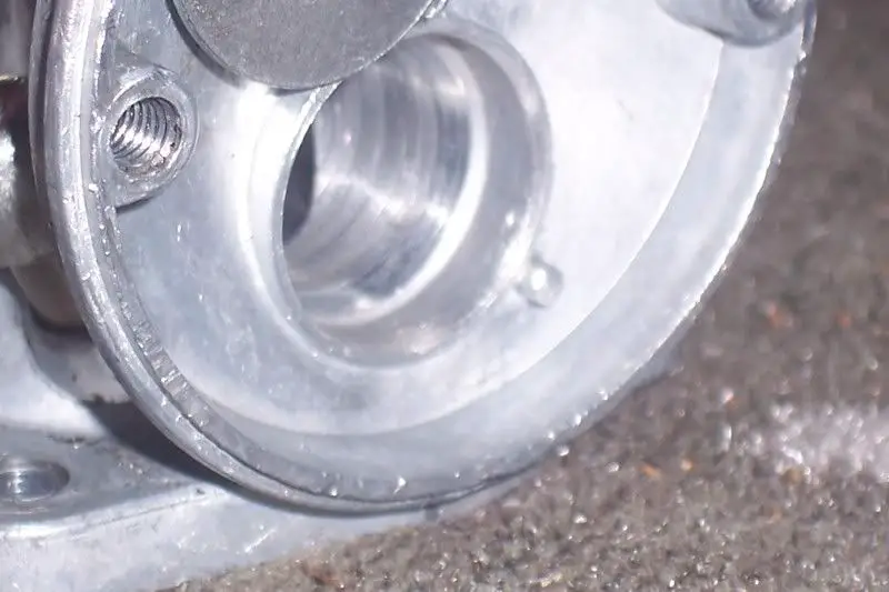

this is what I did with mine
I smoothed out the entry & actually honed the bore as large as I could without interfeering with the sides of the slide
it definatly helped

Heres my attempt at removing the lip from the inner part of the carb. I tapered the entry hole with a dremel and a few bits. The first time was done with rolled up sandpaper and stuck in the hole and handspun(firstpicture). I tested this and the bike seemed to have better lowend power.
This is the final outcome done with the dremel tool....You can see how the restricting lip is gone.
