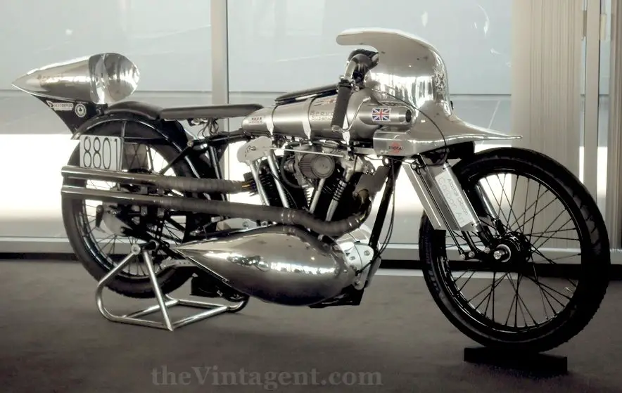

The transition that take place between the final sanding and buffing are amazing!
Ok so one day a Rep. from Rolls Royce is taking a tour of the Brough Superior shop and sees them wearing white gloves as there mounting newly polished tanks and decides to give them Rolls Royce's endorsement. First and only time they gave an endorsement. ......Maybe you should give them a call.
