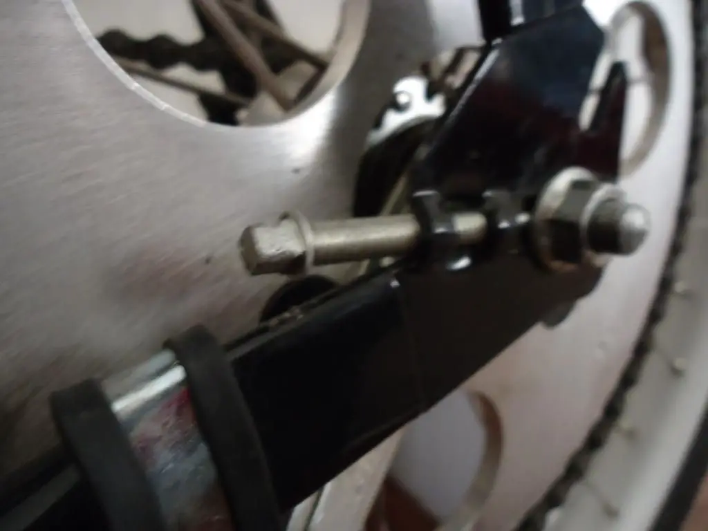

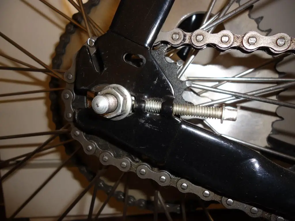

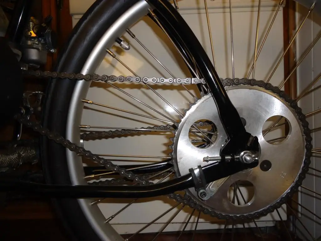

This is my contact for sprockets. Never use to run them now it's hard not too. Adjusted this chain 3 times since building this bike, ride it every day. It just works for me, it also gives you an option for chain clearance. Notice this was added with no welding.

It does make a difference if you are looking for chain clearance. Place it on a screw driver and hook up the chain, try it in both positions. I like the top mount myself.

I am going to have to sort of, kind of duplicate what you have done here. I have spent too much time attempting to get all 3 chanins in proper tension with no tensioners. Shifting components back and forth, changing reat bike chain cogs, spacers, etc. I be ready for the funny farm soon!
Question, is that mini tierod from OMB too that goes to the coaster brake arm or from some other use?

I made the custom tie rod heim joint what ever rod for this bike and now use it on all my builds, it just works so good.
I can say this... The chains will drive you Crazy....
