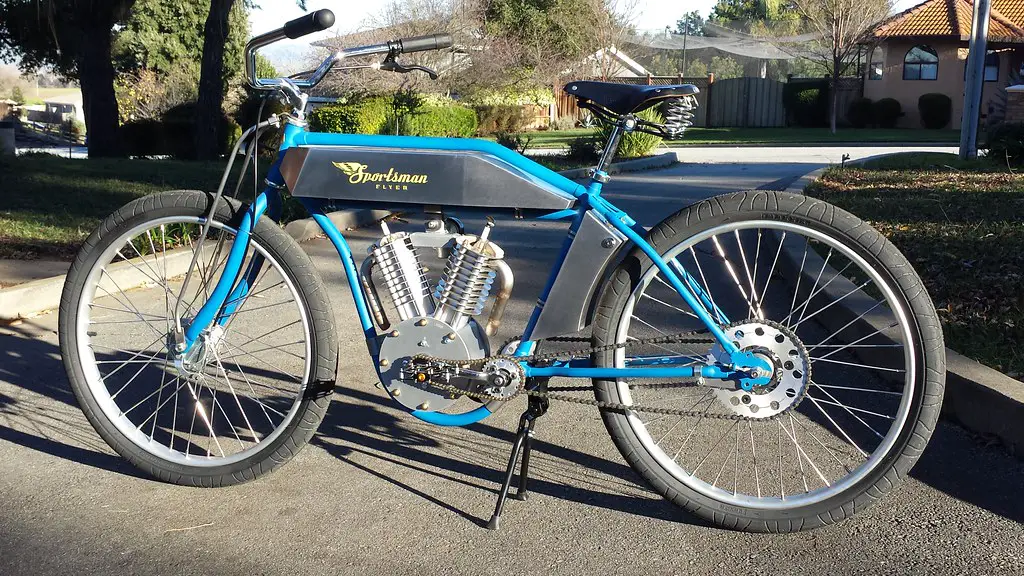

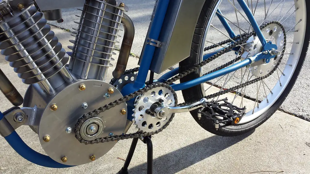

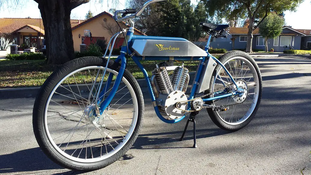

Time to update this thread. I've been busy so not much progress till recently. I have added my electric motor and drive system to a flyer pedal bike I had in the shop so I can test the entire system out. Low option bike with truss forks, drum front brake and Strumey Archer 2 speed click back hub with my new sprocket adapter.
Sportsman Electraflyer by Pat Dolan, on Flickr

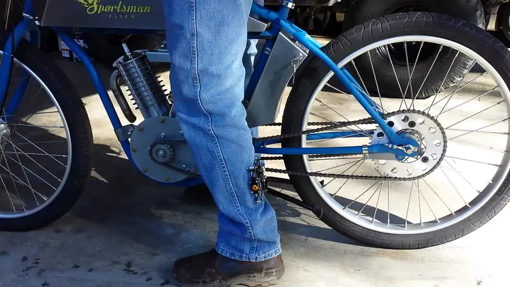

After placing on the ground and pedaling the bike I found it harder to pedal than planned due to the motor cogging effect of the magnets. I had expected this and will be adding a freewheel to the motor drive side. Just that and waiting on the battery. The battery will be 50.4 volts and 28.35ah. Amp hours are basically how much gas you have in the tank and my understanding 28.35ah is huge with electric bikes. Do not know what range this will give me but it should be quite good.

The bike is truly looking beautiful, nice work!
Maxxis Hookworm tires are a good choice; DOT motorcycle rims and tires are even better when to comes to a solid handling feel, and reduced number of flats.
I am looking forward to hearing some riding impressions!

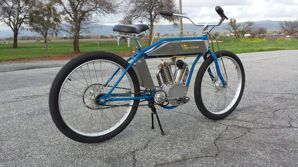

Pat you've definitely encapsulated the vintage look into your Electraflyer design. I confess to having no idea what technical issues might lie in store but visually you are nailing it for certain.

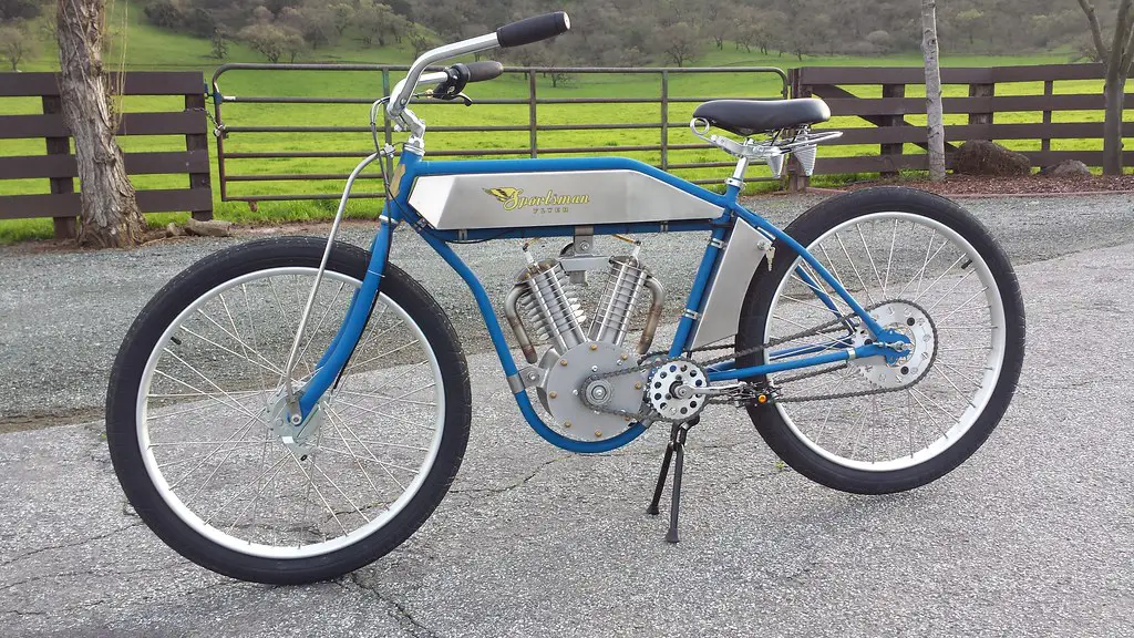

Couple subtle changes while I wait for the battery to be delivered. I changed out the Brooks saddle to something a bit more comfortable. I also finalized the gearing and this allowed me to better position the motor a little further back in the frame so the crank case centers in the frame loop. Little changes make a big difference. It's hard to tell but the electric motor is now wired back into the controller. Still needs the throttle, too. Now it's just a waiting game till the remaining parts arrive.

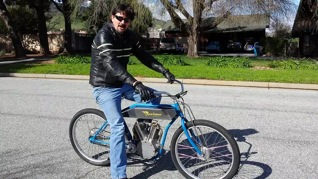

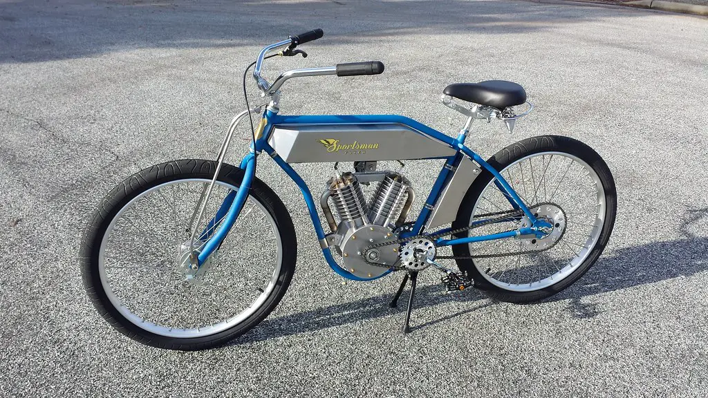

So I am finally to a point where I can give some riding impressions! My 52v 30Ah battery, which will be the standard one used in this bike, is still being manufactured so I am using a loaner to test the bike on the road. This battery is 52v but just 17.4Ah and has a 40 amp max.
First off it's weird turning a bike on instead of starting it up. Just turn the key "on" and it's ready to ride. I found that on the smooth floor of my shop I could spin the rear tire easily enough. The bike pulls nicely off the line, no pedaling necessary, and it can easily accelerate to full speed. It will run at 30 mph. The chassis handles the load just fine with no load issues whatsoever. Really, I know it can handle way more power. My understanding is this current battery has about 1/2 to 2/3rds the power of what the other battery will have. Is it a cool ride? I think so. Is it fast? Well, right now it's fast enough and has enough power to accelerate up the hill in front of my house. Certainly no pedaling required. I would say it pulls harder than a HF79cc four stroke but has less top speed. Next battery should run 45 mph. Where this bike really shines is it is so simple to operate and it's quite! You can sneak it around anywhere. It also seams lighter than a gas bike. I can certainly why electric bikes are so popular!
Here it is out in the real world.
Sportsman ElectraFlyer by Pat Dolan, on Flickr
A 52v 30Ah battery will be the same speed as a 52v17.4Ah battery,
The higher Ah will get you more mileage.
You would have to increase the battery voltage to be more powerful.

Pat you're Electra has turned out beautifully and the ease with which you handturned the pedal lever was impressive and demonstrated to me that it was going to be a great bike to pedal.
Do you notice much braking effect from the motor? Rick C.
I am more of a gas motor guy and my experience is lacking a bit with electric bikes. Volts do equal rpm and at 52 volts my motor should spin 3224 rpm regardless of Ah. With my gearing that would be 40 mph. If the motor can push a taller gear then I may see 45 mph. My controller is set up for my next battery which is a 60 amp battery. My motor/battery/controller supplier tells me my well used current 40 amp Nickel Mag Cobalt battery cannot flow enough current to my motor so the voltage is drawing down below 52v under load. He calls this "sag", which I am told is common with this type of battery. My next battery is a Lithium Ion using 18650 cells and is rated at 60 amps. He feels this battery will be able to better supply the large electric motor we are using and not draw down the voltage. If correct I should see a true 52 volts at the motor under full load and then 40 mph with my present gearing. Testing will tell. Part of coming to this determination is that on speed tests our system was shutting down on low voltage. It's a big learning curve for me, but I'll figure it out.
