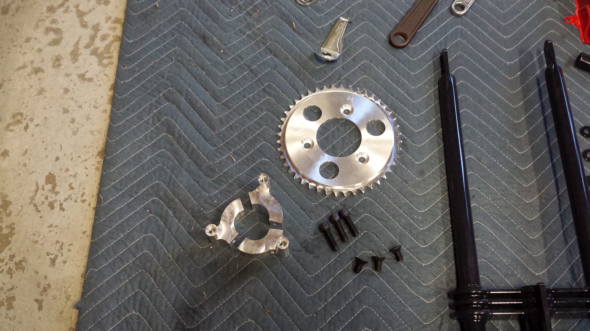

Here is the Sportsman three piece sprocket adapter being installed on my Worksman rear wheel.
Sprocket Adapter by Pat Dolan, on Flickr

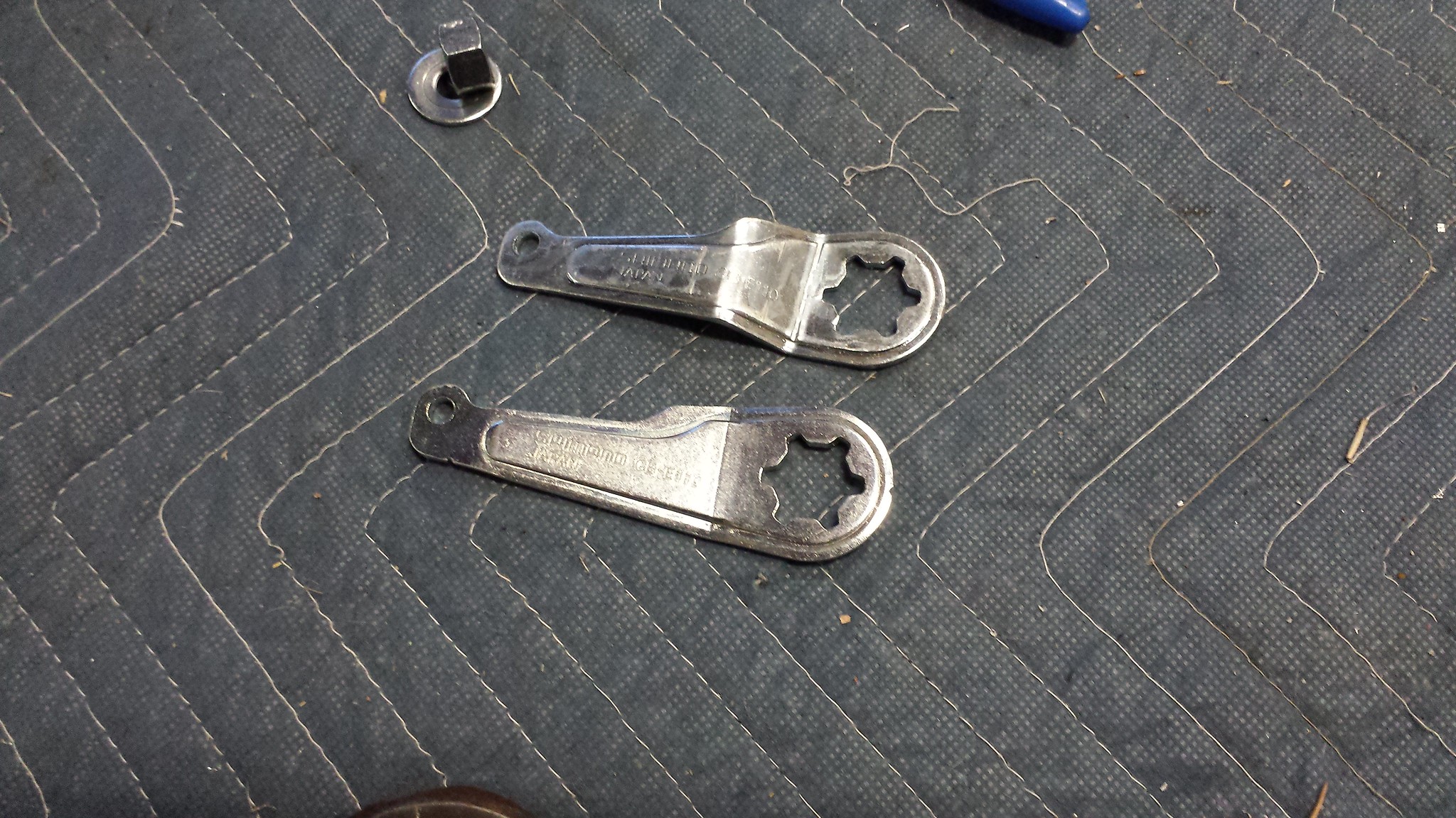

Due to the sprocket offset I need running the four stroke with my reduction drive system I need to modify the coaster brake arm. This is not necessary on two stroke builds, but with the four stroke I need all the offset I can get.
Brake Arm by Pat Dolan, on Flickr

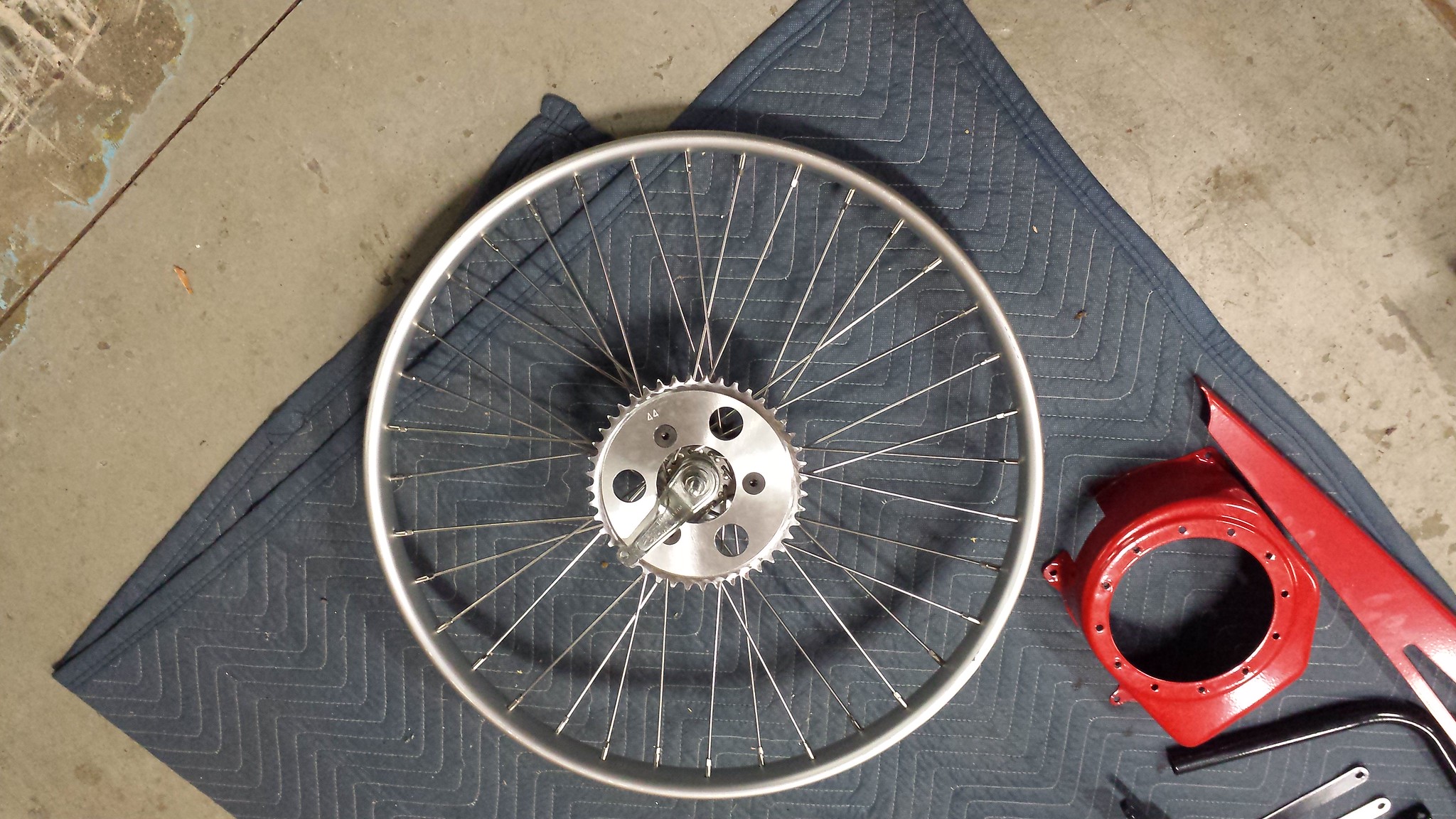

And here it is with adapter mounted. By the way, I now only use the aluminum Worksman rims and not the steel ones. The aluminum rims have better manufacturing so the quality is superior to the steel rims. They also come standard with stainless spokes.
Worksman Wheel by Pat Dolan, on Flickr
Pat I don't know if you can boast the virtues of your 3 piece adaptor in this thread but if you would at least describe the amount of clearance gained on sprocket offset, or PM me & extoll away. Thanks Rick C.
My adapter design is pretty well documented, but one of the nicest features is it easily installs through the fat Worksman spokes without bending spokes or grinding on the adapter. As far as offsets once I modify the coaster brake arm it is no longer the limiting factor. I can then run the sprocket all the way away from frame centerline until it contacts the frame, then I just move in just enough to not rub the frame.
