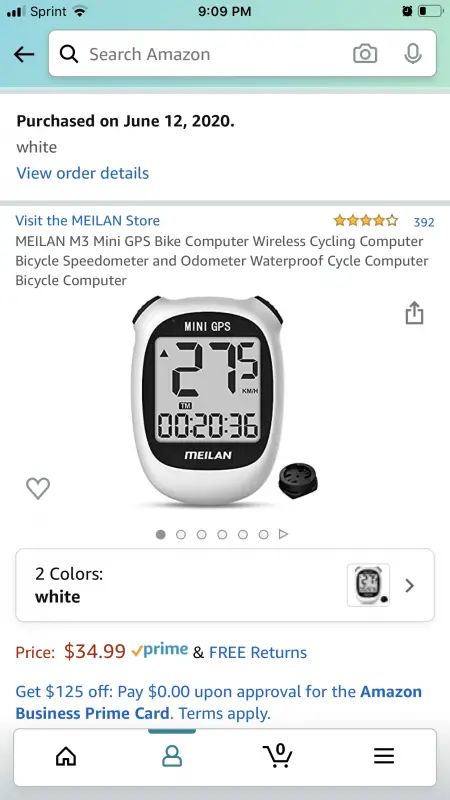

I tried wired and wireless, both died quickly, currently I’m using a meilan gps speedometer, no interference and east to install. The one I bought is currently $34 on amazon but when I bought it it was $24.
also it’s usb rechargeable and easy to use.
