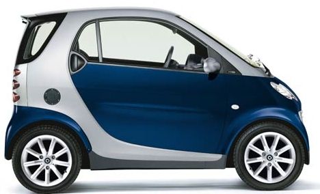

Even the light aluminum wheels should be overkill on strength. Only reason I know weights is checking around for drag skinnies. Some drag guys use smart car and VW beetle tire sizes on fronts. Those should be the right width if you're new tire shopping. Or you can get the ones specifically made for spare use. I've never tested, but I'd bet the true spare tires have a much softer compound that wears out faster.
Not sure if they are exactly the same as yours, but we do have them here. Ours probably loaded down with an extra few hundred pounds of safety systems.
