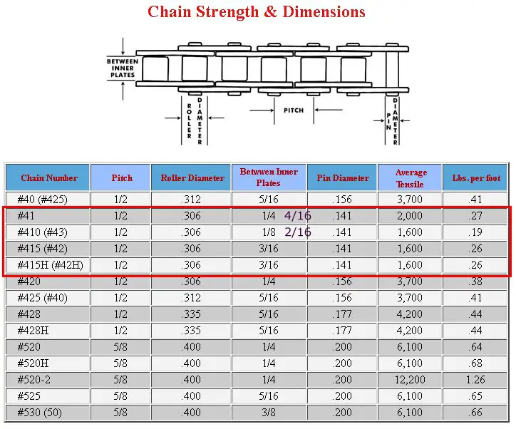

the chart says the 415 tensile strength is 1600, that must be kg right?
I was reading through this kmc chain guide
http://kmcchain.us/wp-content/uploads/2013/05/ChainGuide.pdf
it says th k710 is 1300 kg, and they have a k910 that is 1500. so the 415 is stronger, which makes sense looking at it construction in comparison. I guess I'm hoping to make the pedaling smoother, feels clunky right now. my second k710 arrived today so I will swap out the right side chains soon, then I can see how well it holds up.

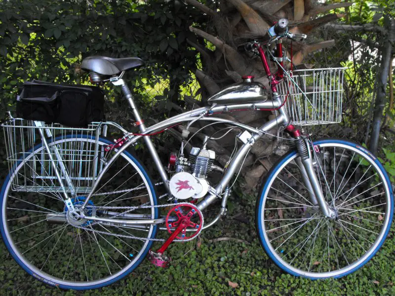

I think half link for 415 Industrial Trike may indeed be a problem to find. I know what you mean about the cotter pin half link, but I have found standard 415 half links w/o the cotter.
Still I've never used them. I don't run any tensioners- a decision arrived at before the newer spring loaded things- but always set the Motor chain first with no half links and then match the pedal chain. Smaller rear motor sprocks always have better frame clearances than larger ones- the bike below has a 34 alloy sprock disk brake drillings directly bolted to drilled flat sided large flange hub with titanium bolts.
