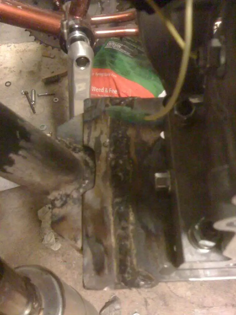

Front motor mount is welded to the frame. I'll be welding the rest of the mounting plate to the mount later. Rear motor mount is only welded to the plate right now. I had to crank the voltage on the mig up to six to get a decent flow.

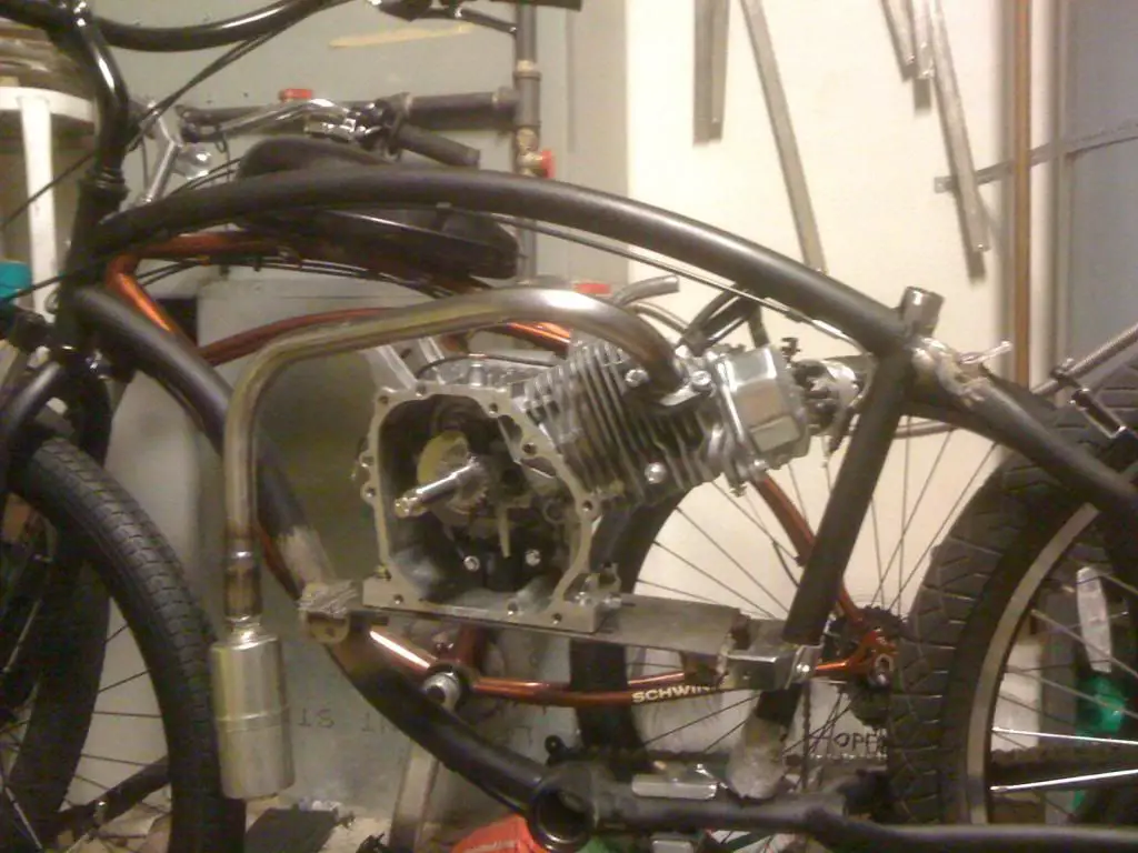

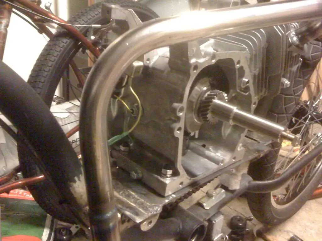

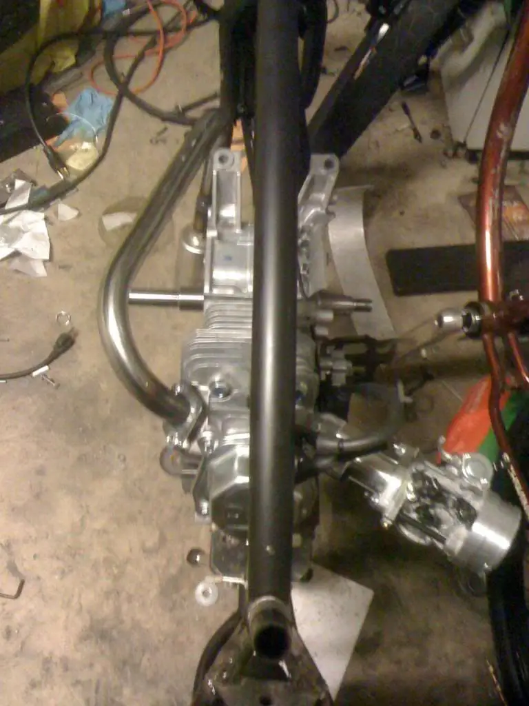

Motor loosely fitted, and does have some rotation play for chain alignment later
The exhaust pipe might need a rework later. I think it's sticking too far out.

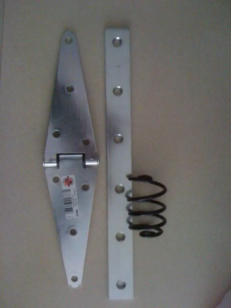

I"m building a suspension seat with ideas from lowbrow
http://www.lowbrowcustoms.com/index.php?l=page_view&p=tech_how_to_mount_a_solo_seat
Their seat hinge cost a whoopping $49
with the following parts at your local hardware store
the door hinge is $22 and a mending braze for $3.49
There is another spring in the garage somewhere.. These springs came off the Firmstrong chief seat.
The seat post will be welded to this and i'll be using the cloud 9 seat
Looks cool; I thought you were going to cut off the top of the seatpost tube and weld the hinge flush with the bike frame's top tube.
atombikes, I did grind the seat tube and about to weld it to the frame. But I didn't know if it's gonna work out or not and thought of I should keep the seat post if it didn't work out. This way, I can remove everything and not still have the seat post useable later, and be able to adjust the height/angle at the same time.

I'm also reworking the mounts to move the engine forward by 1/2" and 1" higher as the CVT is right by my knees. Reworking the seat since the puch wheel will allow for more space to play with.
