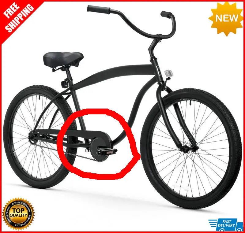

What to look for on the location of the seat post, notice it is mounted behind the pedal sprocket housing a few inches.
The image shows the difference.
