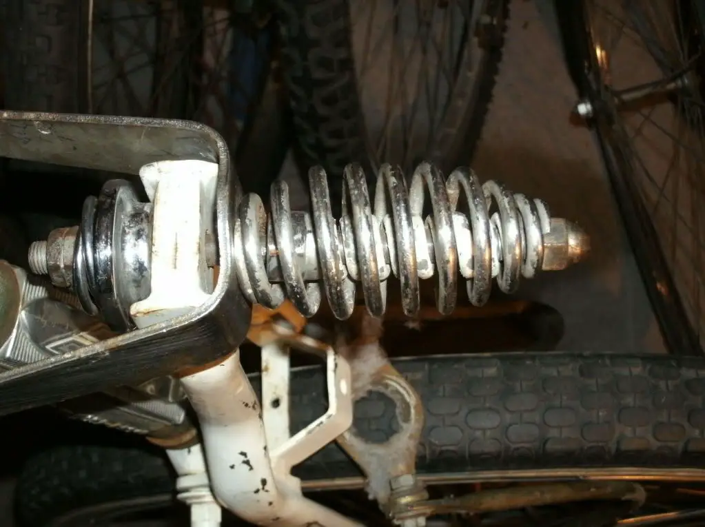

I was hoping somone might have this springer front fork. i want to use it on this build but it does not seem right. if any body has any pics. of this fork setup they could send or post i would be graetful
thanks pacesetter...

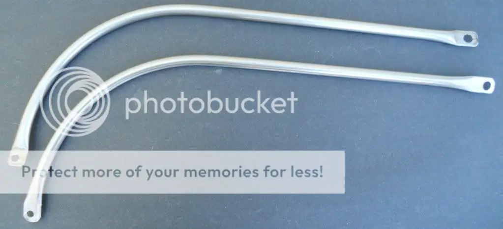

Without knowing that springer, that's what I was thinking, that it needed truss rods of some sort as you'd find on a Schwinn springer (which were missing on my Schwinn). I don't know if the Schwinn rods could be adapted to fit yours, but it is worth a look.
Bicycle Parts This is where I bought my Schwinn parts.
SB
thanks SB i think i have some truss rods that will fit. i am looking for the springs close up view. i sent a message to luxlow but he never got back to me. Thanks for all the help

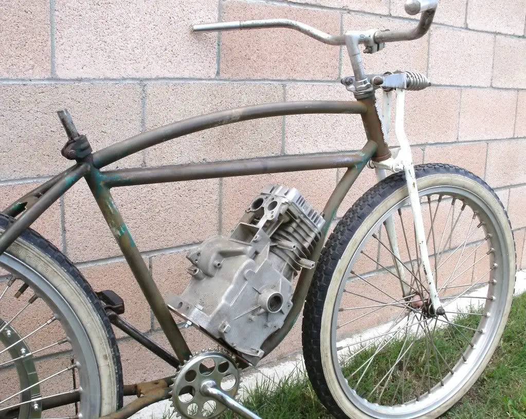

Hey Happy New Years to all and thanks for checking my post out. the engine is a 5 hp. brigss that has been shaved. if you want more pics or any other info. let me know how i can help.
Thanks Dan. I do not think they are the same. the one he sells are like a schwinn spring fork wich only have one spring the shelby fork has three springs. I am making some progress and will post more pics in a few weeks and look foward to your commets

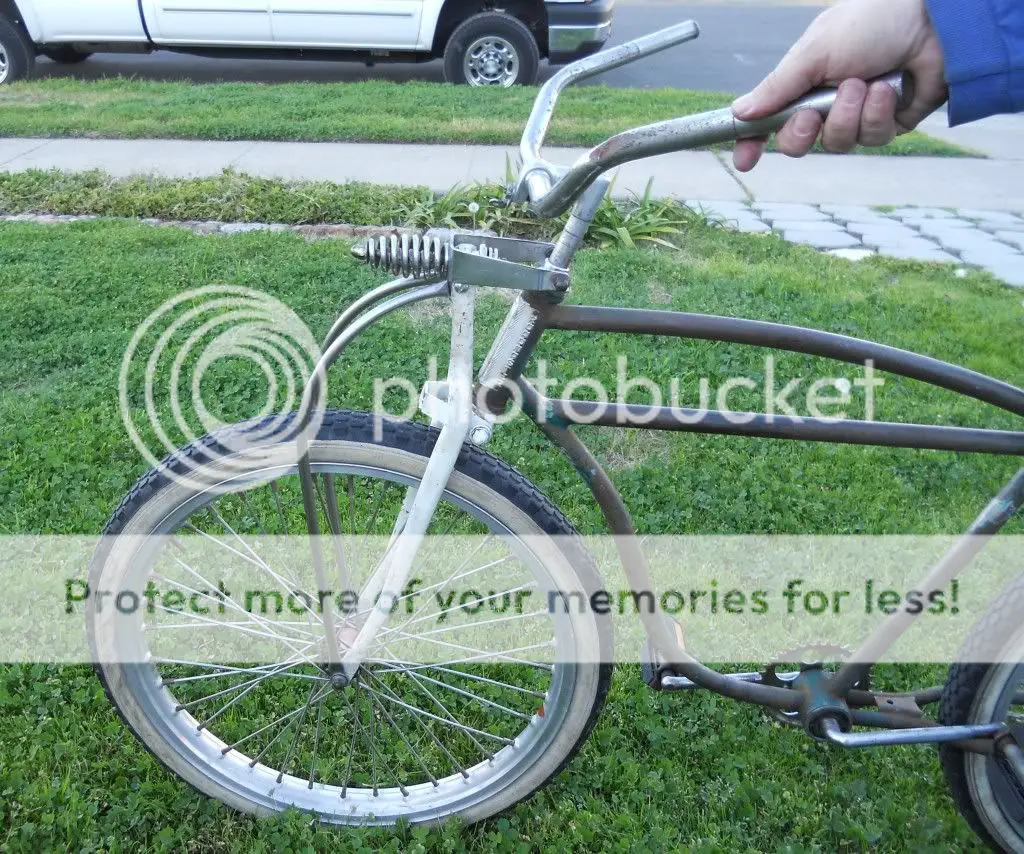

We finally figured out how to make the front springer struts by looking at other bikes and photos. Had Railmakers of Costa Mesa bend up some 1/2'' stainless tubing. We formed the ends, drilled the appropriate holes and mounted them to the bike. Looks great and is structually better. Now pacesetter can concentrate on motor mounts and a million other things to get his Briggs bike going. Thanks for the input we received from forum members. It all helps.
Looks really good. I hope the thread of this build continues here or somewhere else so that I can follow it. It is going to look awesome with that straight bar frame. With engine at that angle, will there be any problem with lubrication? I'm contemplating a similar build with a 50 Schwinn Panther so will be watching closely what you do. Your build is an inspiration, so thanks for sharing...
