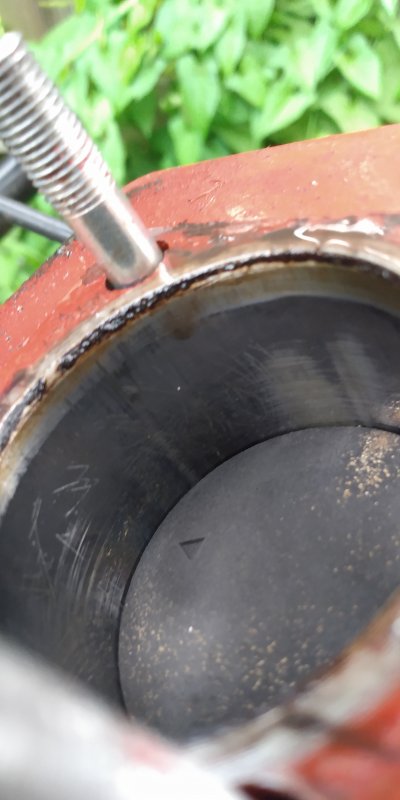

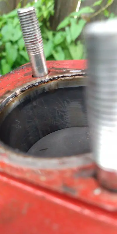

R Rob145 New Member Apr 18, 2021 2 0 1 38 Jul 9, 2021 #1 is this normal on a bike only a few months old Attachments IMG_20210709_200550919.jpg 46.5 KB Views: 60 IMG_20210709_200539553.jpg 45.8 KB Views: 59
Larry Trotter Well-Known Member Nov 26, 2017 476 306 63 76 Jul 10, 2021 #2 I wou pull the cylinder off and look at the piston and rings before deciding what to do.
Greg58 Well-Known Member May 1, 2011 5,353 2,575 113 66 Newnan,Georgia Jul 10, 2021 #3 If you can hang your finger nail when scratching it it may hang a ring, from the pictures it looks like the person putting it together sanded some surface rust off.
