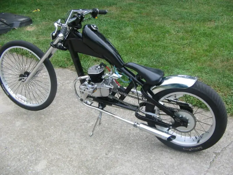

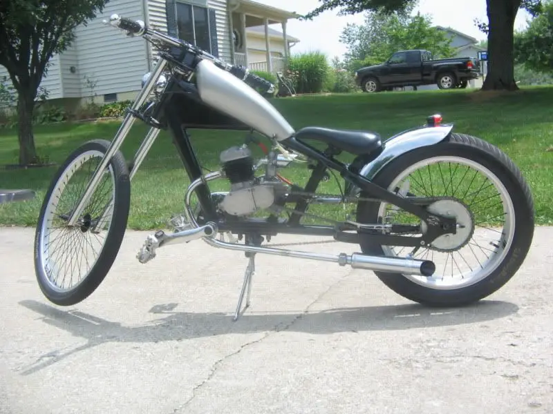

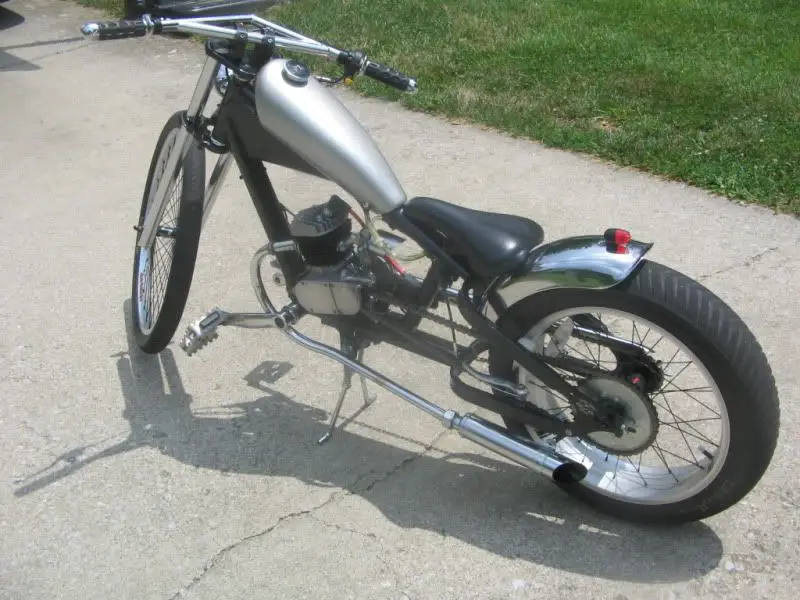

here's what mine looks like.
currently i have the gas tank off because i decided to re-paint it AGAIN.
here's what it looked like with the tank painted black (the first paint job)

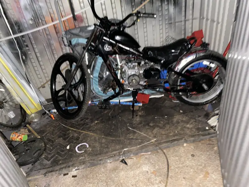

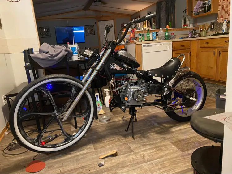

wasn’t hard
