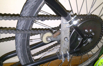

So I got the motor mount on (it's not quite level, but it's pretty close...is that ok?)
Now I'm thinking about the chain tensioner. I bought a nice one from phantom bikes, but I have to figure out a way to get it to fit. As you can see in the pictures, the loop things that are supposed to hold it on, are too big. I may just have to go see if I can find new, smaller, ones of those, but I'd rather not if I can help it. I thought about using zip ties, but that puts the chain tensioner too close to the sprocket. So...any ideas?

I have seen those clamps at Home Depot in varying sizes, I was going to use them myself for making a homebrew chain tensioner, before I went with a spring loaded one.
The mount plate can be a little bit off level front to back, but you want it pretty darn level left to right so the drive sprocket is not at an angle in relation to the rear sprocket.
As for the "P" clamps that mount the tensioner to your frame, they come on a variety of sizes at most hardware stores and are not expensive at all. For mounting a tensioner, stay away from the nylon plastic ones if you can. Stick with the rubber covered metal ones for the sake of durability. If a plastic one fails, it could cost you $$$ in damages and repairs.

I second Gearnut's suggestions. Also, in the picture you have the tensioner upside down. The narrow part goes on top. I believe you'll need the 5/8" size clamps. That's what I used on my Clairmont but you'll be mounting it closer to the rear than mine so you may need 1/2" since the tubes get smaller to the rear. Don't even think about using zip ties. Also, when you clamp it on you are going to have to play with the orientation of the clamps to make it parallel to the chain since the chain stay and seat stay tubes angle away from the hub to the seat tube. I suggest that with the two bottom clamps, you orient them in opposite directions like in my attached drawing so that it is close to parallel with the chain. Please post a picture once you mount it so I can see how close the pulley comes to the rear sprocket. I'm very curious.

The reason I had it upside down, was because I think it may fit better like that...I need to mount up the engine and put the chain on first, though, to see :)
