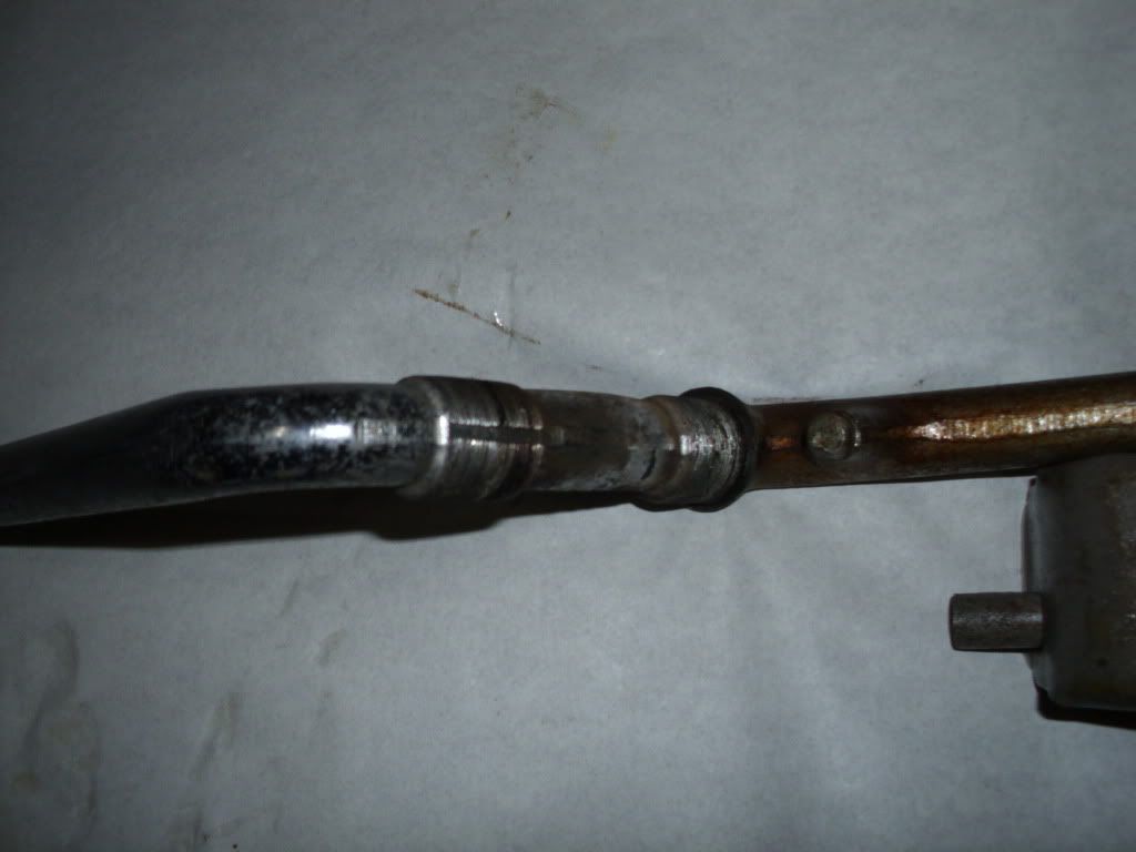

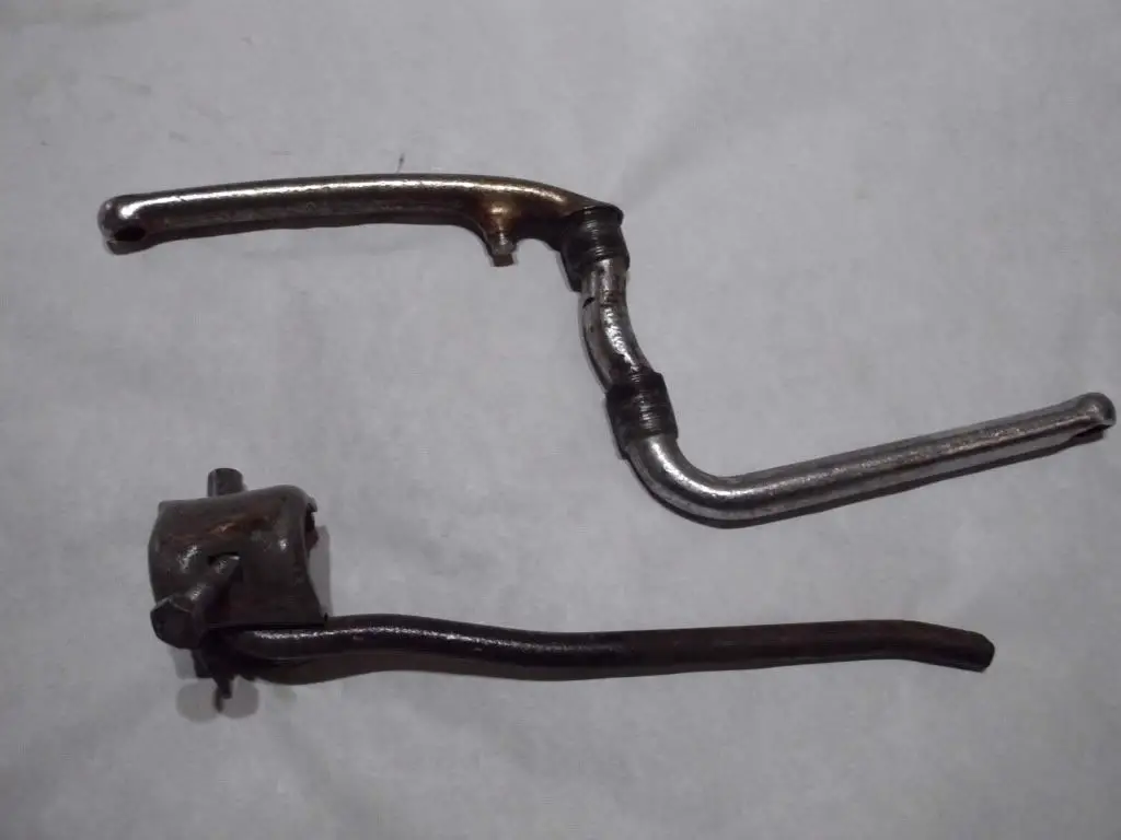

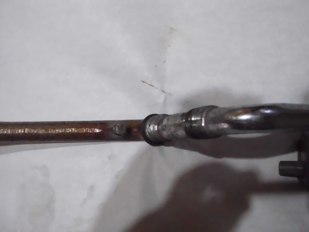

I used a mixture of 50% White Vinegar and 50% lemon juice to remove the rust from my parts and this is without me scrubbing or even wiping the parts down at all!
The peddle crank was only treated on half, while the other side was not. The kickstand was only partially treated as well.

If you go back and read my description, you will that I said that I only dipped part of the peddle crank in the solution, that part has no rust on it. The part that was not dipped was so you could see the difference it made. (^)

I miss interpreted that I see it now ''sorry''. For a sec I thought it was not working to its potential. Looks very good actually!!! Carry on....:oops:
