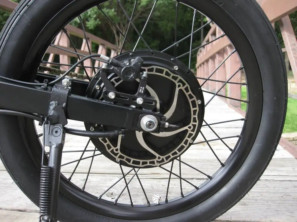

I decided to maintenance my brakes, and replace my white Thick Brick tires. These tires are the second set of tires I've tried. The first were super bad city chopper low profile tires from LuxLow. Their problem was, my rims aren't wide enough for their super low profile, so the tires profile was squeezed, and distorted. They felt weird to me when leaned over. I had a like new set of white thick bricks already in hand so that's what I went wth. These are what I just removed. I estimate I had about 2200 miles on them. The front didn't look to bad. I wouldn't have changed the front if it wasn't white. The rear still had some tread but on this bike even new tires are probably pushed to the limit. I don't need to take a chance.

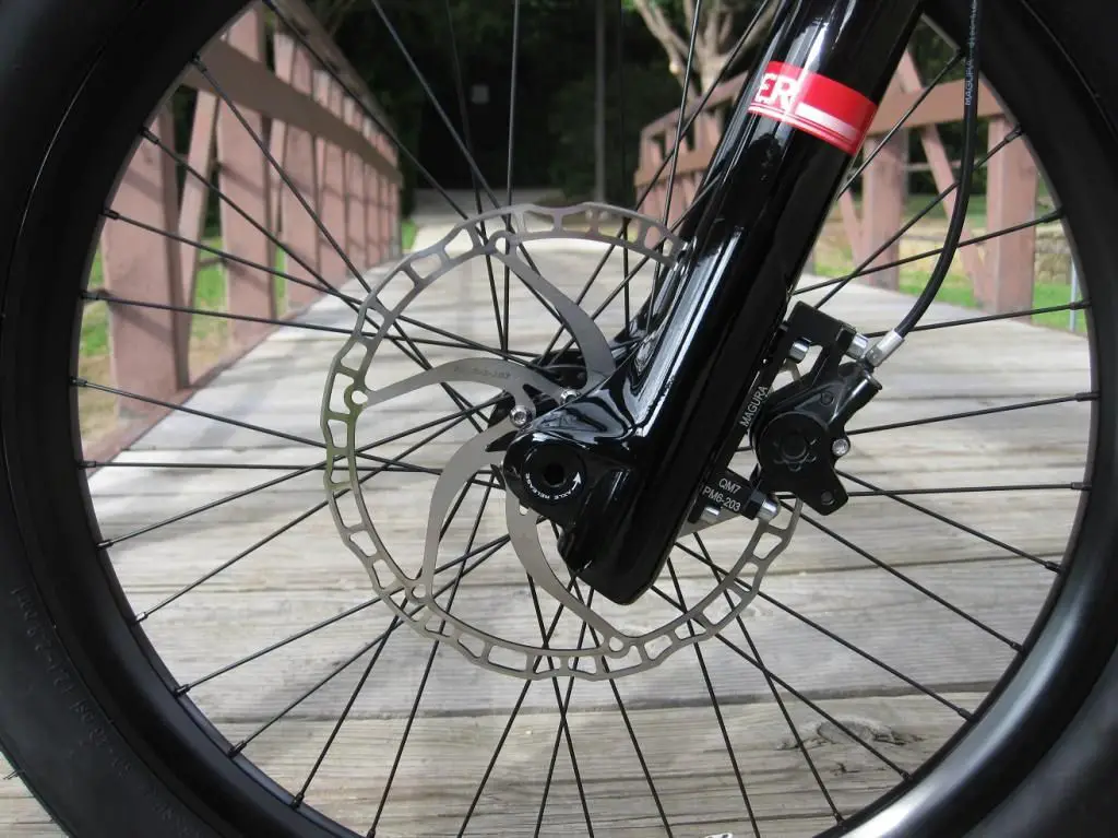

My rear rotor was slightly warped, and made a tic tic tic sound that was annoying, so I planned a while back to replace the rotors.
The stock Magura rotors always seemed kind of noisy, so for replacements I bought, a pair of Ashima Airotor Mountain Bike Disc Brake Rotors, 203mm on eBay.
The new tires and brakes have been installed several days now, and feel like they're broken in. Since I also changed the pads it's hard to directly compare the rotors, but so far I'm very happy with the stopping power, and sound they make.
My new tires are the supposedly the same thick bricks, except in black. Although they look about the same they're not exactly the same. These are 1/16" narrower, and 9mm bigger circumference. The rubber compound seems softer too. I definitely like the black tires better.

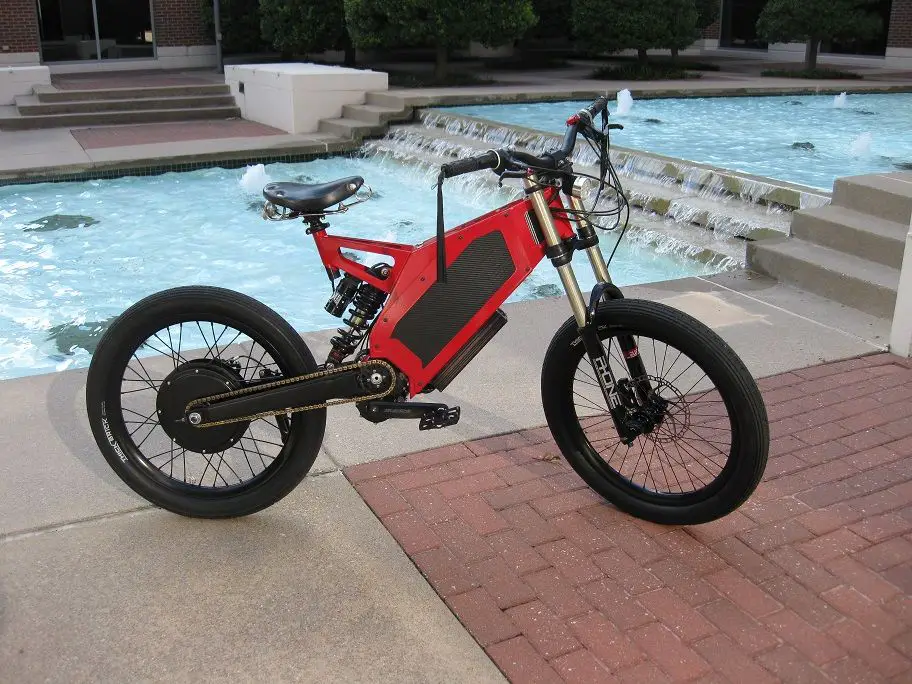

Jus' wonderin' what width rims do you have? It'd help me determine how far I can push low profile tire width without crowning too much...
The rims on the Stealth are 29mm wide. Those Low profile tires from LuxLow fit best on rims that are 50mm wide, like on my Felt Deep 6.
Tires like the Thick Brick's are actually a little wider than the LuxLow tires, but they'll fit on narrower rims because the sidewall is so tall.

Someday I'll buy an extra motor and lace 24 x 2 rims to it. 24" rims are my favorite size for looks, I can't explain why. 26's look too big to me, and anything smaller than a 24 doesn't look bicycle enough for me, 20's excepted, but that's different.
Those low profile tires look great on any bike, but these thick brick's work very well with what a Bomber has going on.
On this bike you have to consider the forces the whole bike is subjected to at speed. Then it all gets applied to the tires. Don't tell anyone, but it's not uncommon for me to be going over 50. A pothole or just crack in the road could cause a bicycle tire to blow with these forces. The bike weighs 100 lbs. and I weigh 225 lb. but that's about 1050 at 50 mph lol.The low profile tires weren't as confidence inspiring as the brick's are. The brick's are definitely more heavy duty, especially the sidewalls. I feel pretty safe with the bricks as long as they're not showing much wear. I run Mr. Tuffy tire liners in them too.

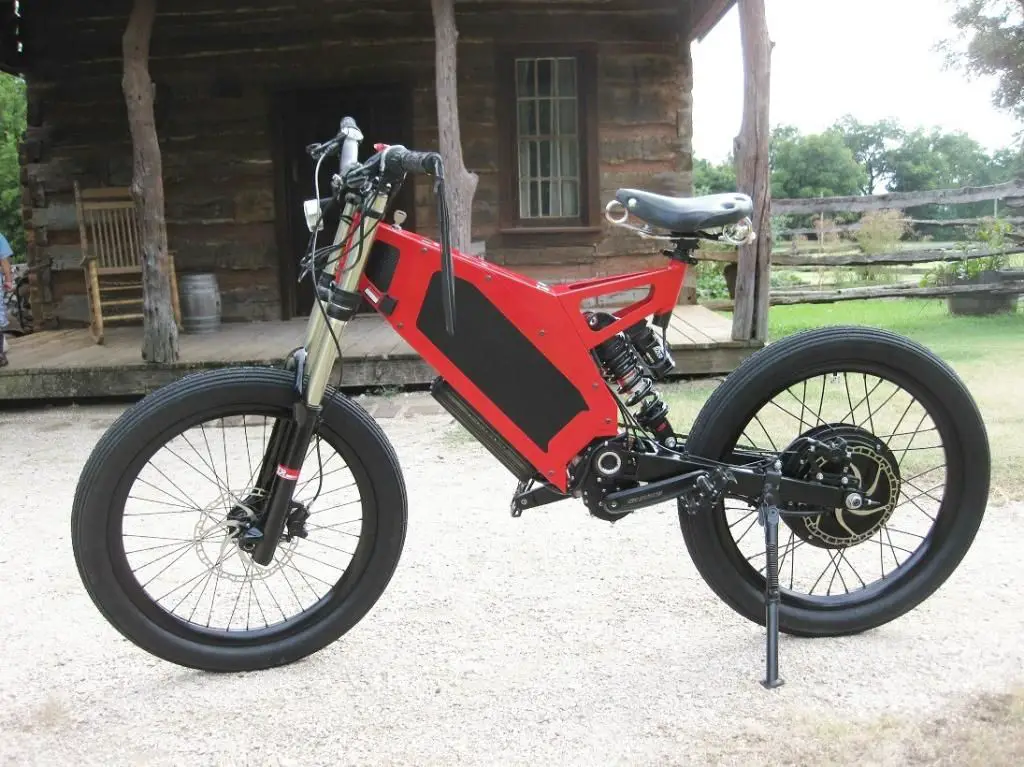

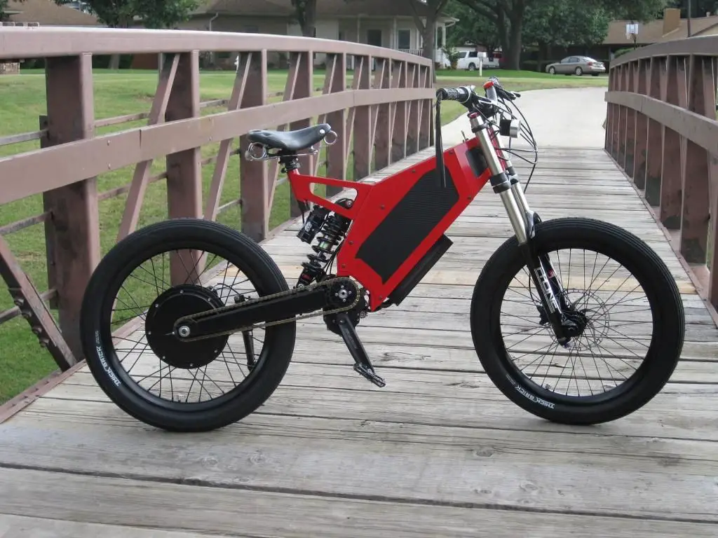

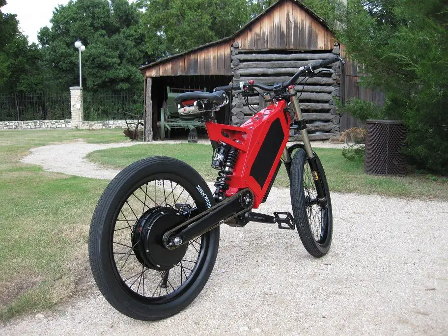

It looks a lot smaller when I'm riding on it, than when I'm standing next to it. It is kind of tall. It has about a 32" seat height with my weight on the bike, and I have a 32" inseam, but at least I can get both feet on the ground at stops. This is with the forks lowered 1" in the trees. That's amazingly low when you consider the 10" of suspension travel on both ends. 24" wheels helps too. As you can see, my seat is about as low as it will go.
The tires are always 24", but the bricks are so tall profile they're almost as big as 26's. Even with the forks raised in the trees the pedals don't have a problem with striking the pavement. I don't think I could get away with any lower though.
It looks tall and short with me riding it, but the handling is vey stable at speed, which comes in handy when you're in heavy traffic moving at 45 mph. It's better than my Tomos, and there's no comparison with my china girls. I guess that's a tribute to the heavy duty chrome molly frame and swing arm. Stealth did a good job designing this bike.
On a scale of 1 to 10 I'd give it about a 7 in the looks department, but this bike isn't really about the looks. It's more about the stellar power delivery, and handling.
