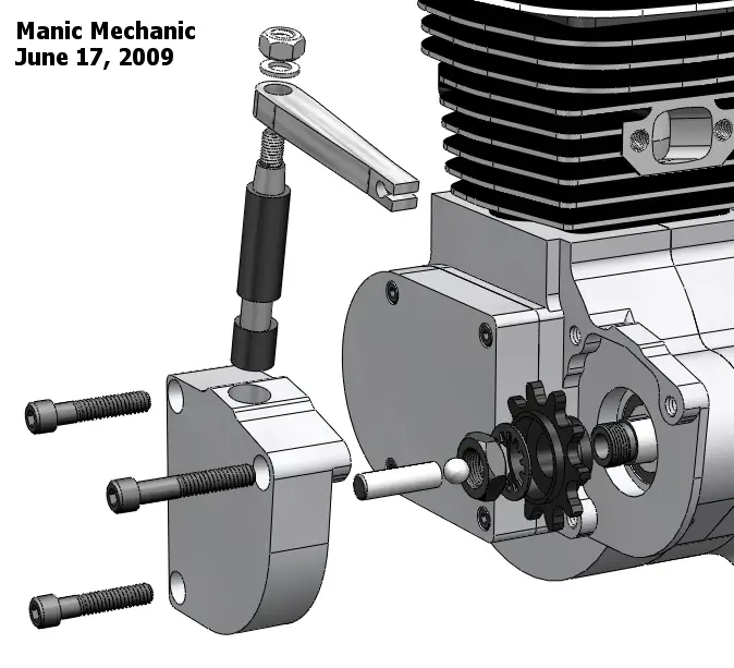

thanks but no,like I said after i unjammed the chain around front sproket,and putting the cover back on theres a small pin that seats in a hole that the flat part of the clutch rod ? must push in to engage the motor ? like i said i dont know much but should that pin be able to come out so easily and just sit there ? thanks

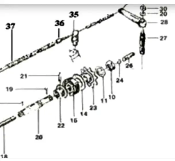

Mark k, The pin is held in place by the cam which is in turn held by the cover, there is a single ball bearing at the inside head of the pin. I have attached a screen shot of that part of the assembly
