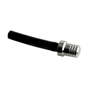

Here is a check-ball vent I made today for $0, but the check-ball shuts off fuel flow if there's no return hose from carb. Best to use a motorcycle dirt-bike tank vent ($10) for gravity feed.
My home-made vent (without check ball it works, but can leak fumes when parked)
picture.php
Motorcycle vent $10 for good metal one
