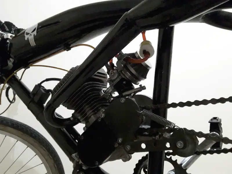

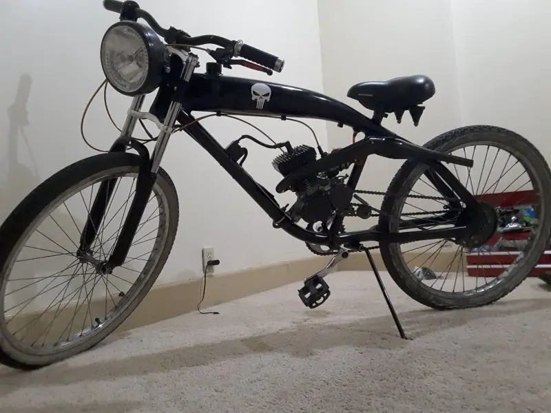

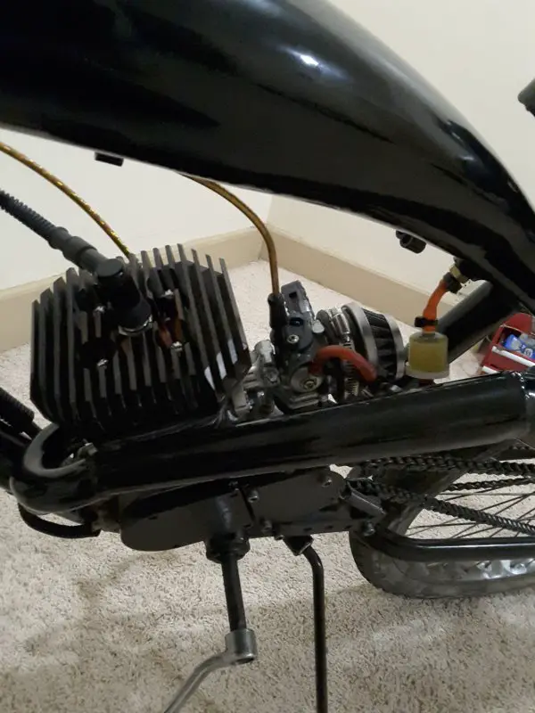

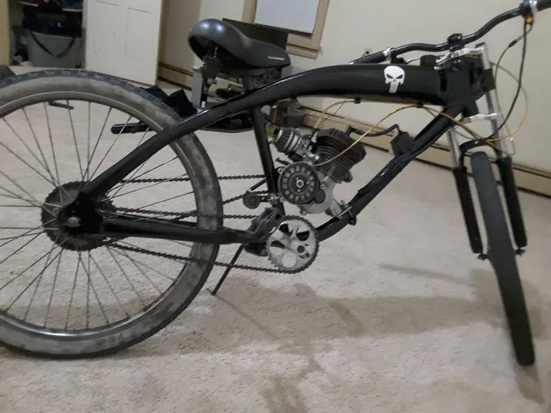

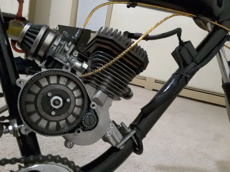

Currently I have a ported short rod with a dellorto sha, thrust ex, Jake head. I've been looking at relatively cheap power upgrades so I can have a monster come spring. I've had bad luck with Reed's in the past (Dio) but I've been considering the g2, mostly because I have also been considering zedas 'pre-ported' 48mm cylinder which comes with a windowed piston, I know it's 1mm but the idea of a bored out motor without changing the crank is attractive. I'd probably stick with the sha maybe a mikuni vm18 clone later on. If anyone has any info or experience(jetting)
on the type of setup I'm looking at I'd really like to hear any feedback.
Just want to add I am familiar with porting though only vaguely when it comes to raising, and especially for Reed valves, the third transfer. I'd love to get into this I understand how it works but I'd love to hear experiences.
Clutch pads are off red ones will get here tomorrow anyone have experience with them?

And yes I'd love to have a k x 85 or cr, mz65 nice pipe but this was 35 dollars and it rips for a bolt on, I plan on mating it with the cdh USA larger nanner pipe later on

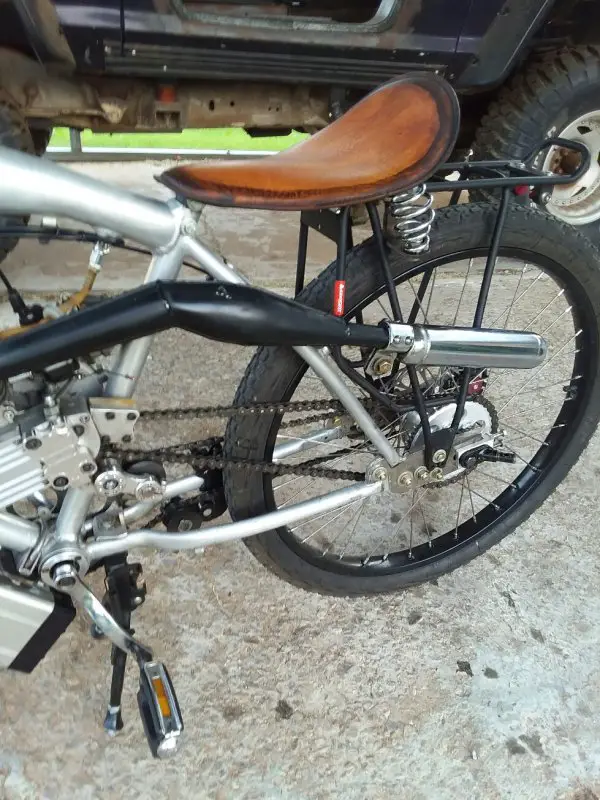

A good Zeda will do 55. What kind on breaks do you have in mind? The CDH fork is known to be unstable at that level of power. Anything over 30 You should start looking at down hill rated fork breaks and a wheel set with good wheel bearings. A wheel locking up at any real speed would suck. I look for sealed bearings.
Yep quality on forks, hubs/wheel & tires. Brakes 200 mm front and rear. Check Ghetto bikes out for quality sealed bearing hubs front and rear or complete billet wheels sets with 12 or 10 ga. spokes. 110mm or 135mm spacing. Rear hub is set up for disk on right side and motor drive sprocket on the opposite. Setup this way lessens brake contamination from two stroke oil, for bikes with left side exhaust. I run the his rear hub/brake on my 2 stroke hybrid e-bike & would run his front hub were it not for the e-motor up there. I run 180mm up front and back as well, but bigger rotors are better...if you've room for them. I'll be going up on rotor size soon.
My hybrid is a Grubee with 5" extension plates gives 53" wheelbase and makes the bike much more stable at higher speeds as would adding a frame to fork stabilizer, which I've run on other bikes that displayed bad manners at high speed, the so called "death wobble", but the Grubee with longer wheelbase doesn't require one. Whatever fork you run no matter the price or quality make sure it has positive trail measurements. My Grubee shows 1.5" positive. My fork is an antique style single spring toggle type certainly not comparable with a good downhill fork and still it tracks well at speed on roadways and not at all an off road setup!.
