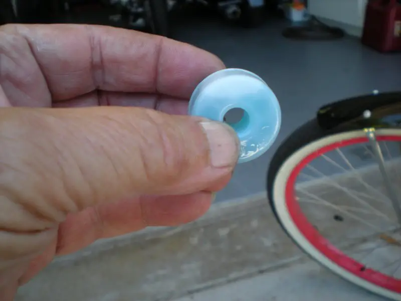

This is ridiculous. Today I push the bike out of the garage, turn on the petcock, fuel runs everywhere. Take the carb off and this is what I see...
So I pull the float out of the original carb and swap it in. Then I go up to Home Depot. The bike ran like it did when I started this thread, but after a while it got going up to 23mph. So the high point of my day was that we were probably on the right track with the "fuel in the crankcase" theory.
