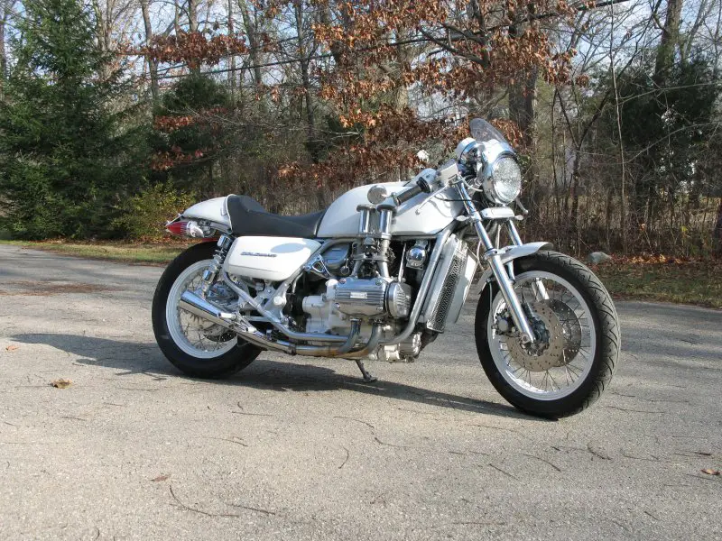

I built this about 10 years ago. I still have it. The Webers are exceedingly easy to jet. Before buying real jets I soldered and drilled out the jets I had while I was tweaking it. That's why I had the micro-drills handy.
