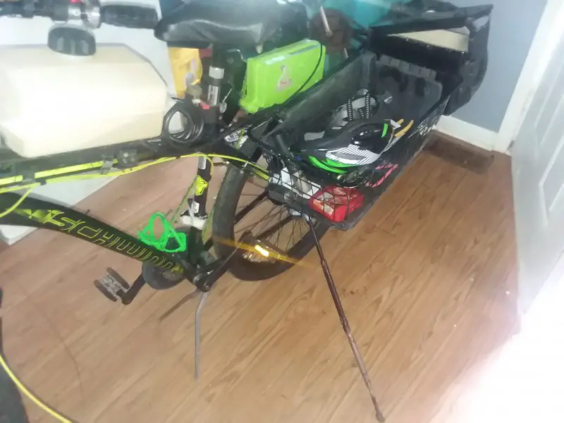

I have a Staton Inc rear rack mount which drives a shift kit. My solution was to add a one side folding kickstand, a left side basket and a long kickstand connected to the basket.
