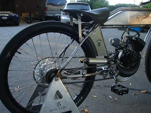

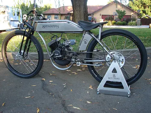

Hi guys,
I have been slowly updating my personal bike as I gain more experience with it. Some mods have been cosmetic and others for performance. I have been having a hard time finding proper sized rear sprockets for my drum hub. I had been running a 45t as it was the biggest I could find. It was alright for higher speed cruising, but made the centrifugal clutch work pretty hard in the Morini engine. I had a custom 48t cut and then a 52t. I find the 52t to be a good choice around town and run the 48t on the open roads. By using a split sprocket system and two master links I can quickly change sprocket size without tearing the rear wheel off the bike. That is the performance stuff. Next, I took my seat pan to a local upholstry shop with a bunch of photos of original BTR seats and asked the guy there if he could make a decent copy of the seats in the pictures. I thought he did a pretty good job and even covered the bottom of the seat as well. The added flaps to the seat really changed the personality of the bike. Kind of makes it look like a bigger, heavier machine. I also added better grips to the bars. They are called Donkey grips, have a nice vintage look to them, and are just a very comfortable and good looking upgrade.

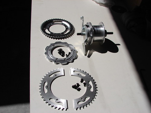

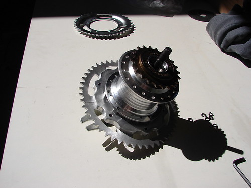

Here are some clearer pictures of the sprocket and adapter plate I used. No more relying on the moped guys to supply me with what I need. This system uses an adapter plate to go from the moped hub standard to the Kart and Jr. drag racing bolt standard. From there I split the sprocket for ease of gearing changes.

Do you have to unlace the spokes to mount it to your hub?
It all bolts right on to a fully laced wheel. I just had a spare hub kiching around that I used to test fit the pieces. The moped hub comes pre drilled and taped with a set of six bolt holes for a sprocket. The adapter plate bolts on to these holes to establish the correct offset of the sprocket and this adapter plate then carries the standard kart sprocket bolt circle.
