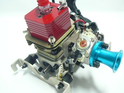

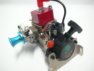

You might try zenoah g43l from Staton. Friction drive though. But I don't know about 425lbs. I have one with an upraded carb and have been clocked at 40. Check it out on YouTube. search "friction drive motorized bicycle by Bishop". Best two stroke I have ever owned.
