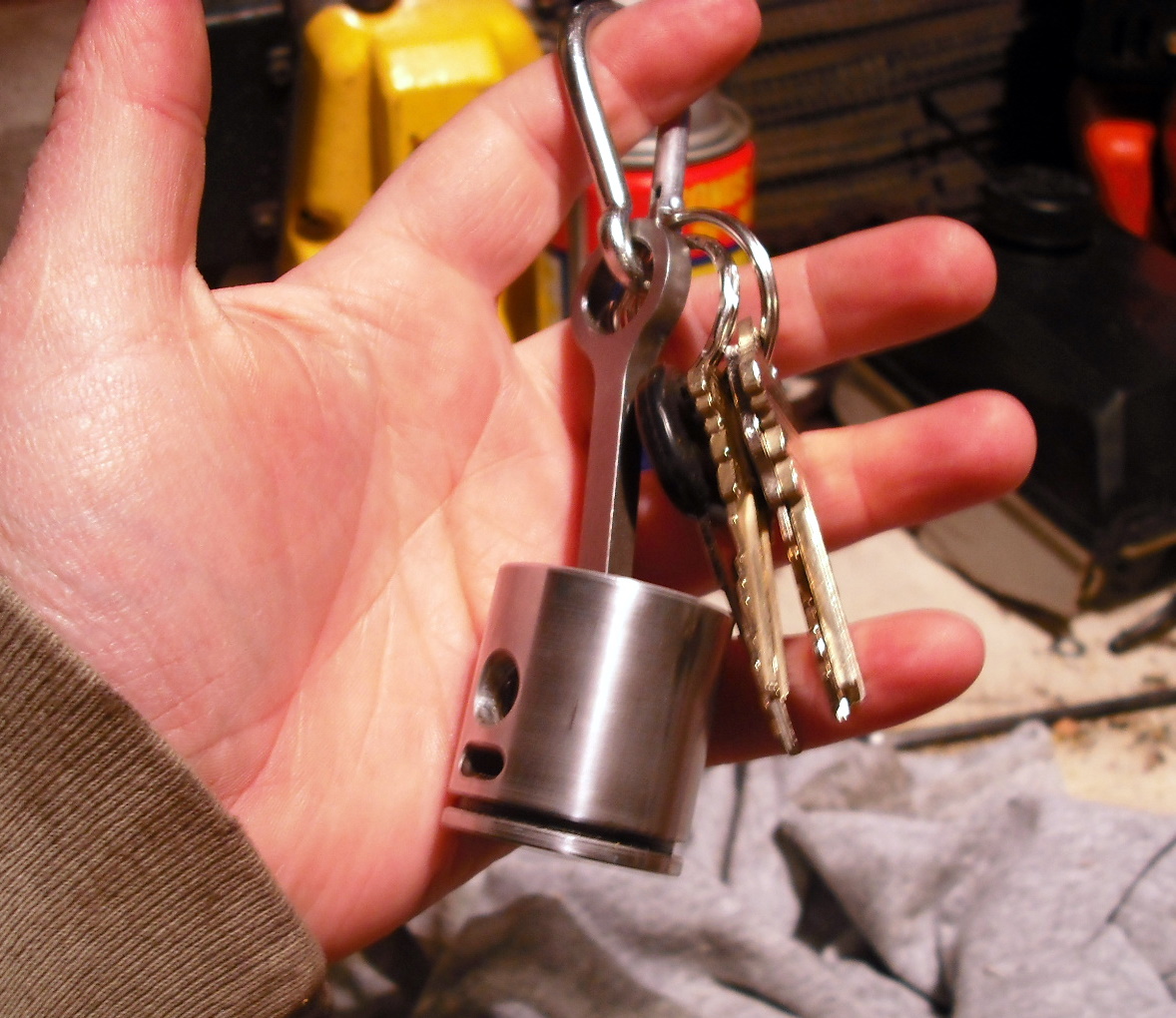

Deacon after you get done stripping it you too can have one of these:
I got it out of the 25 or 30cc craftsman DOA WW I bought. I had a fun time stripping it down after she wouldn't start for me, The picky little SOB. Jeez I gave her spark, fuel and lube and still no love. Seems They have to have compression too... Funny a broken ring just threw it all out the window for me.
