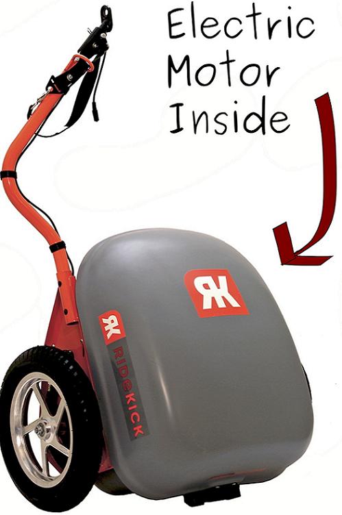

BigBlue,
This trailer tracked well without wagging while being towed at all speeds.
When I switched to push mode (using the engine), the trailer got unsafe at speeds over 20 mph. Motorcycle trailers are tow behind & not powered to push. Pushing changes the dynamics.
