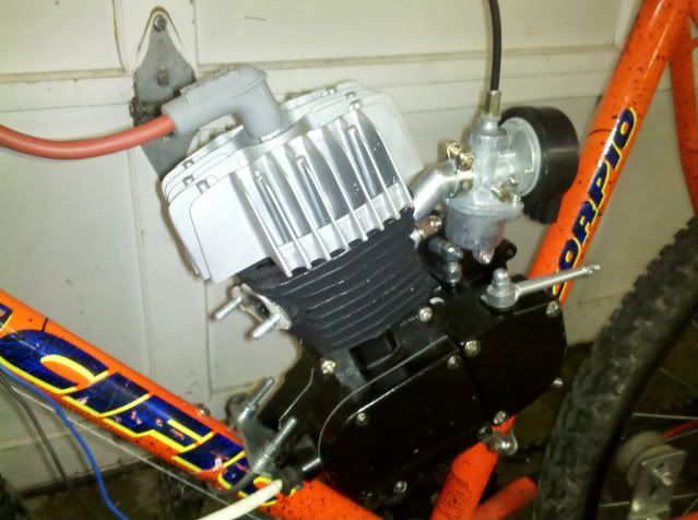

Puch Moped Head on HT 67cc bicycle engine- thanks Foureasy!

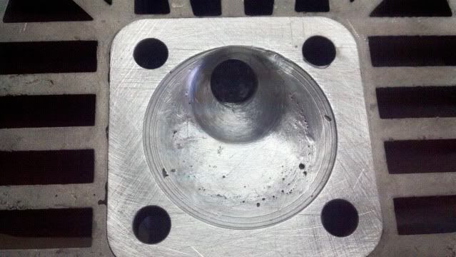

Click on pics and check the squish...cheers!
Scotto- That Minarelli head looks so sweet! Nice find- now do you know if it has the same bolt pattern measurements as ours? Looks close...

My puch head wont bolt on. seems the stud is too big.
Re: Puch Moped Head on HT 67cc motor- thanks Foureasy!
So long as the hole pattern is identical to your factory HT head, make the holes bigger in the puch head with a drill bit. It is best done using a drill press to ensure that the holes are held perfectly straight, but a steady hand and a careful eye can do it with a hand held drill as well.

did the head make it any faster? I tired the 70cc puch head and I could not get a socket in the head to tighten the bolts.
yeah u gotta use nuts that use the 13mm socket or it wont work. thats standard for M8 nuts.
yeah it gained more rpm, lost torque because it lowered compression. smoothed it out a lot

Did Youn put the 50cc hi hi head on a 48cc or a 66cc? Or is is possible to mount the 50cc hi hi head on a 66cc or do I need the 70cc hi hi head cause I messed up and bought the 50cc head when I have a 66cc motor.
Braiiiiins. But yeah, the 50cc fits on a 66 china girl.

If I remember right I *think* you have a 13:1 compression ratio... 70cc head on a 66cc is supposed to be 11.5:1. If you do have a 50cc head on a 66cc you will need an NGK B9HS or equivalent to prevent ping.

thanks guys. I got it on but can't even turn it to start it with the shift kit. plus i checked the piston clearance and the piston is goinna hit it. I dnt wanna ruin the shift kit so i probably gonna sell it and get the 70cc. I may try doubling up the gaskets but I really got the head for the added cooling more then the compression.

On some of these Motors the port timing is a little low set on the jug itself. You may find benefit in shimming the jug up with a thicker gasket just a tad as well.
