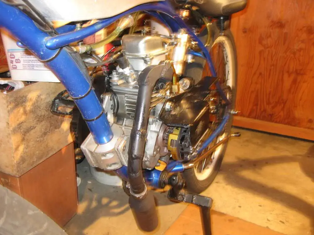

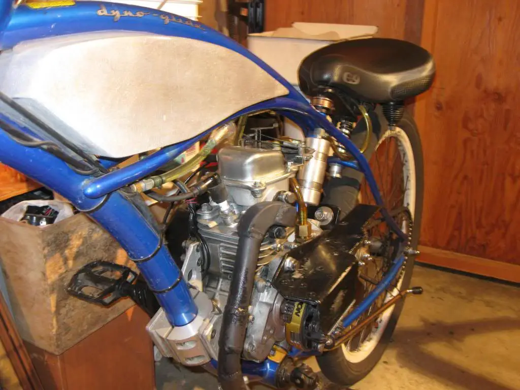

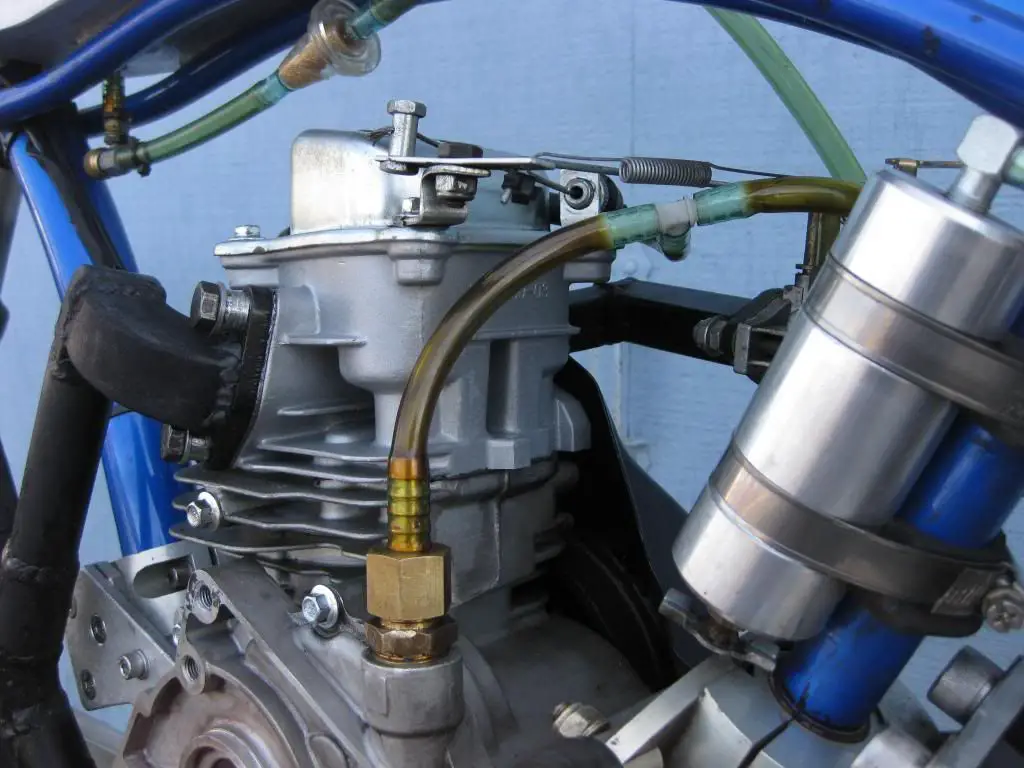

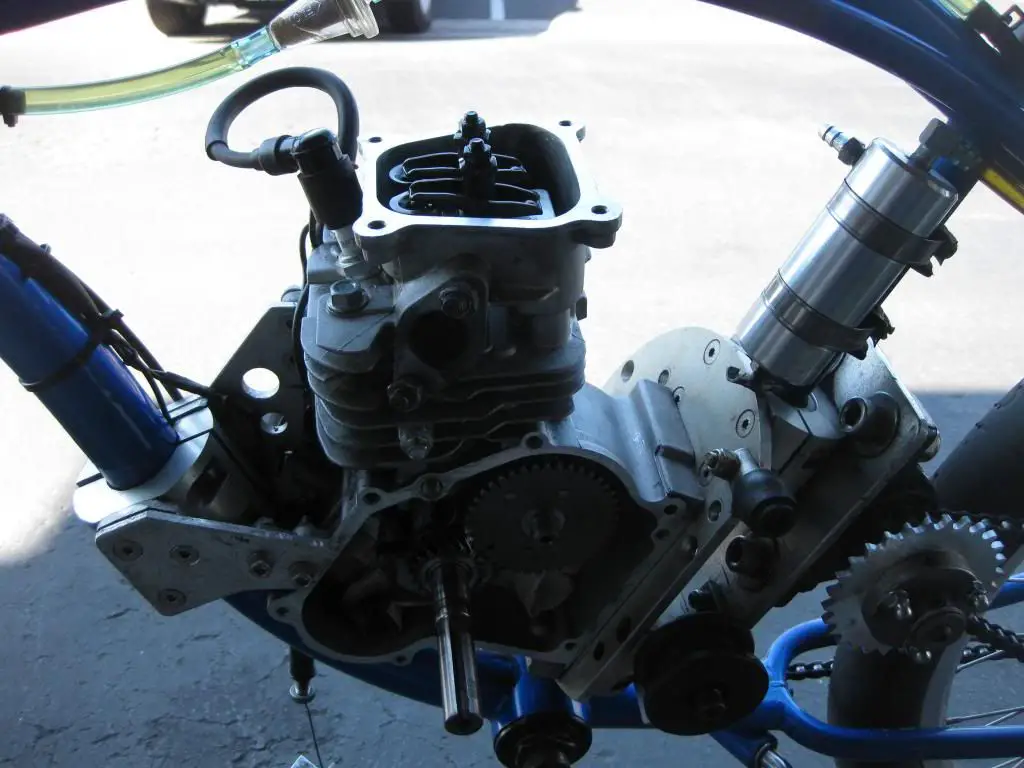

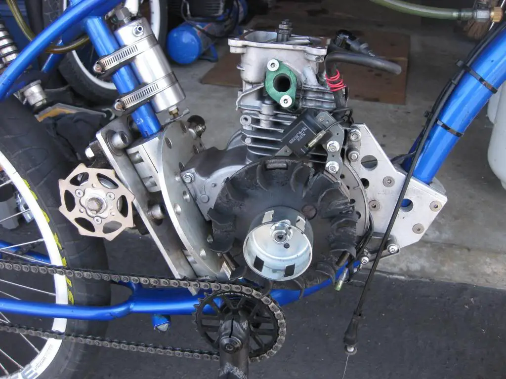

Well then speaking of gear ratios.....changing some gearing here, but not the ratios I was running originally on this bike. Also decided to do some performance mods since they became available. This is still my commuter bike and I don't consider it a race bike, however, I do plan on racing this bike at the next Grange race to drum up some competition and to show Bigboy cycles what a soon to be hopped-up 99cc Predator runs like, compared to the stock one they raced against at the first Grange race this year. Yes that's right.....it won't be so stock this time around, have a peek....
And for the record (whatever) this engine will go from approximately 3-3.5HP, to a whopping 5HP......look out! My 212cc is already shakin' like a leaf in fear of this monster lol.

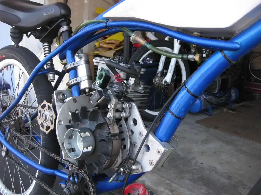

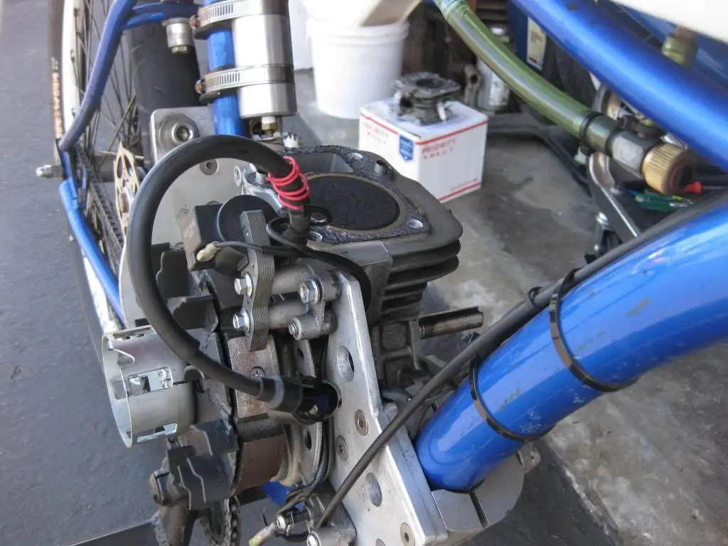

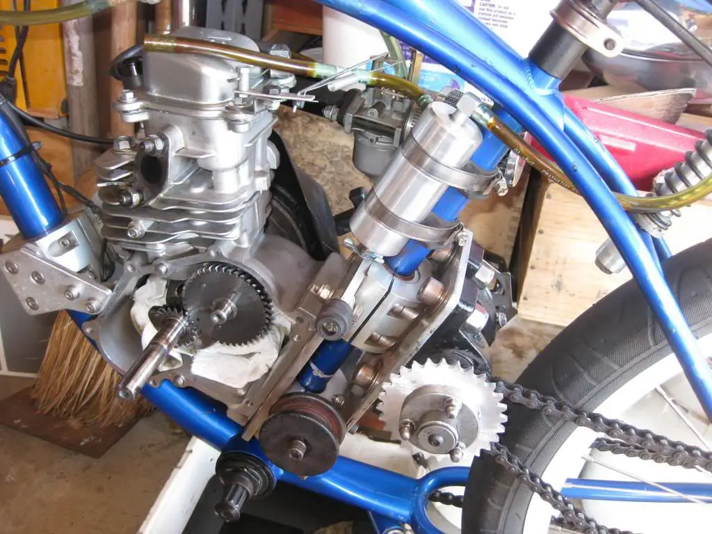

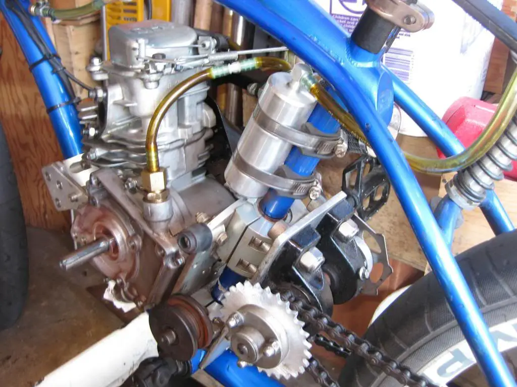

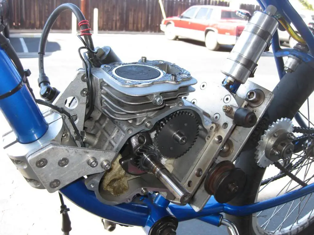

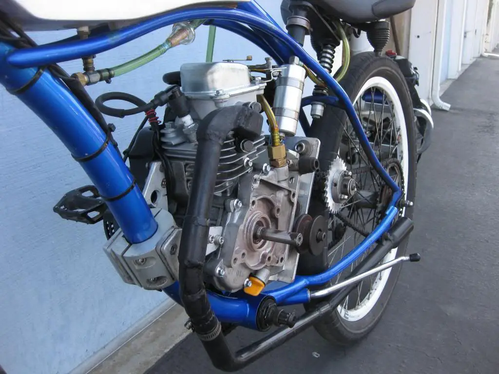

Here are a few spy pics of the engine being mounted.......
Now try to imagine the frame being the same color as the engine and mounts....
I did say imagine.
Just going back through the build. Did you use any kind of liner in the mounts or just metal to metal? Awesome bike.............Curt
Hey Curt, the clamps that hold the engine plate to the seat tube have a fiberglass/resin composite sleeve, then and aluminum sleeve that are sandwiched to the seat tube. So fiberglass is in contact to the steel Dyno frame there. The front mounting clamp is straight aluminum to steel frame. Tight tolerances on all clamps.

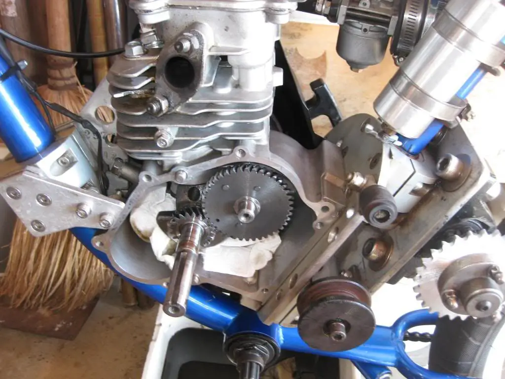

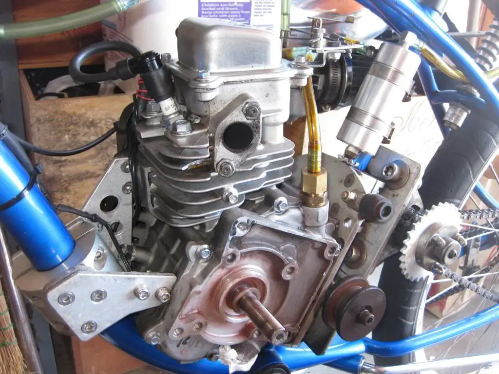

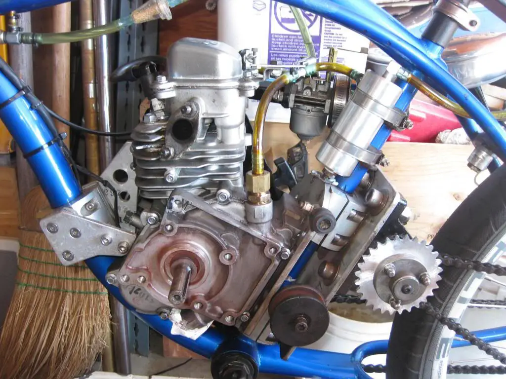

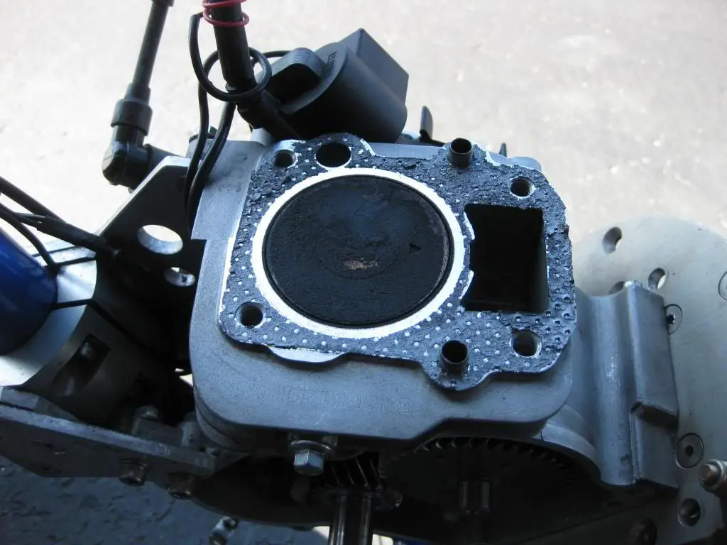

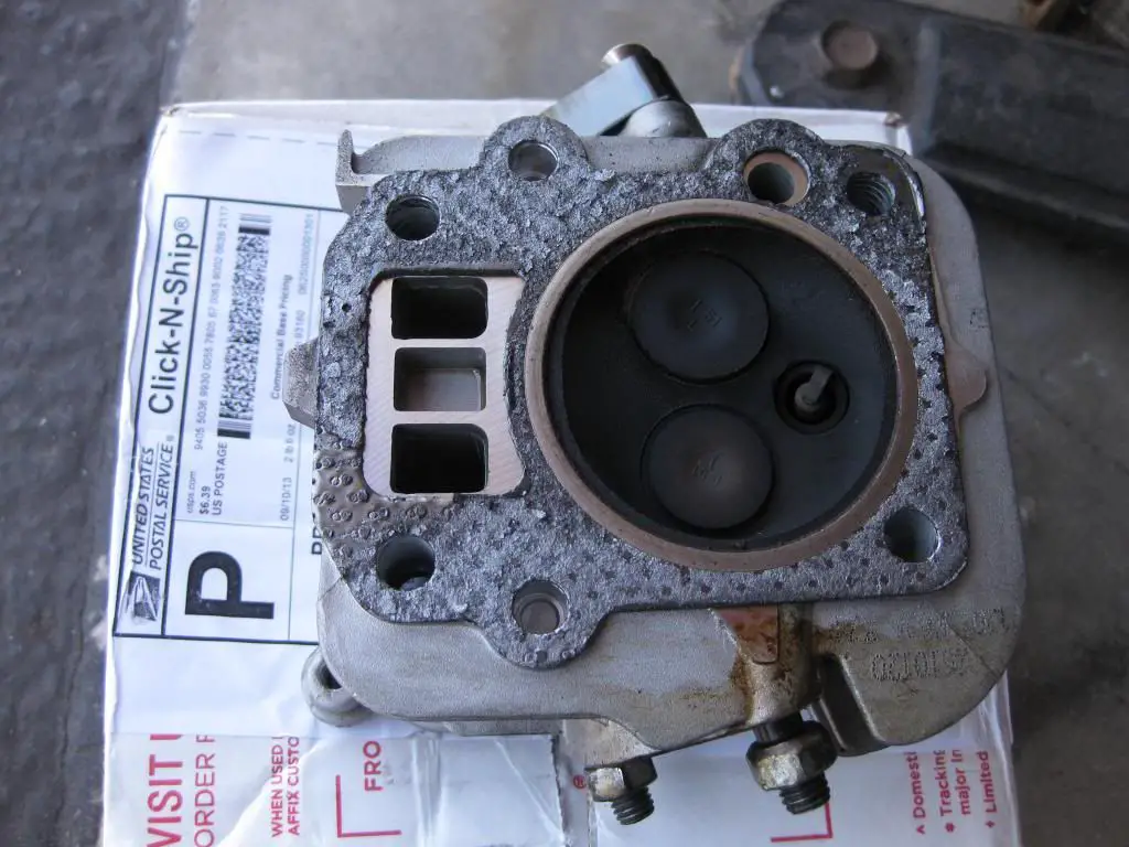

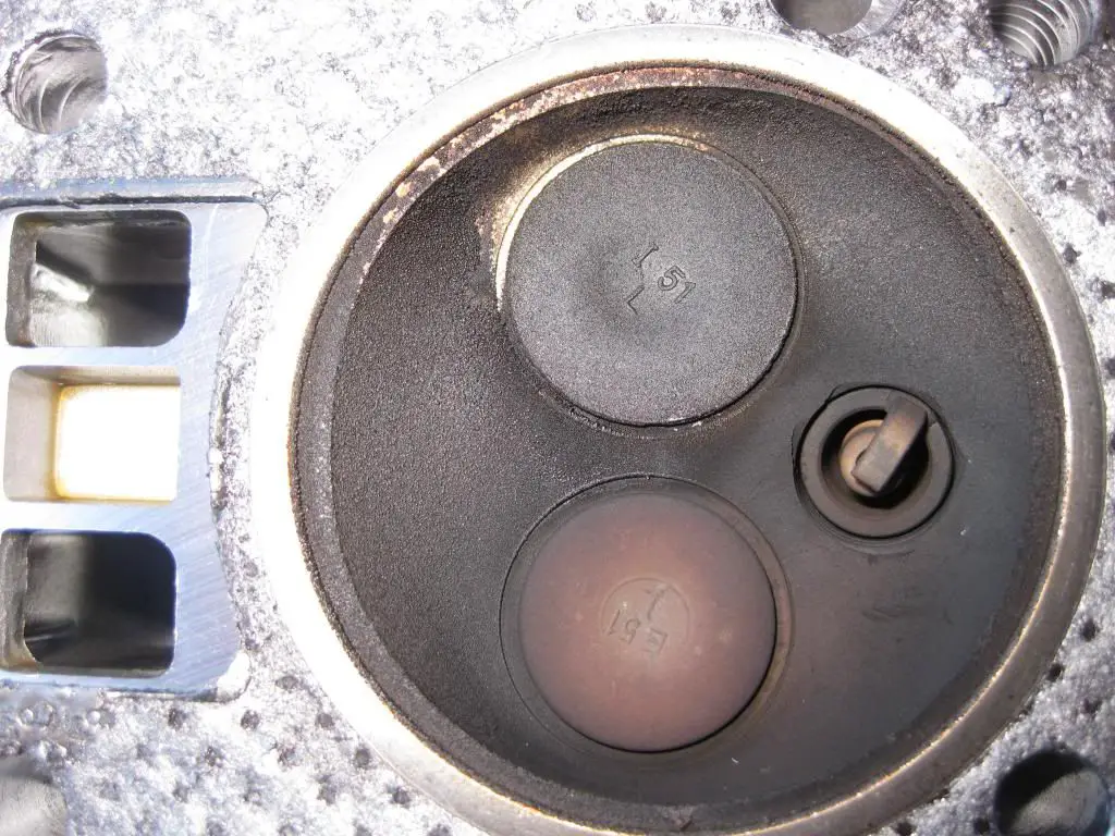

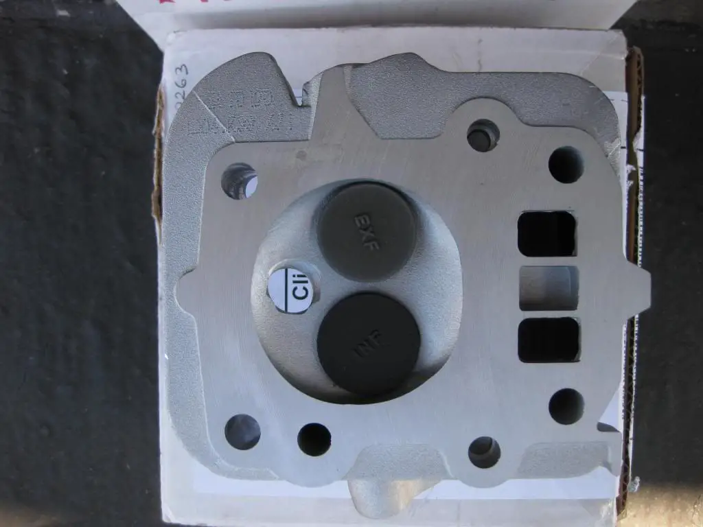

Got a fair bit done on my cruiser today, tore down the engine and installed some new goodies. This engine has just over 50 hours on it and really looks good inside. Here are some pics for the day.....
Coming up next.....I've lost my head!
AWESOME THANKS. I am going to do some mounts prolly out of steel and i will figure out something to line them.

So Scotto-
Since you sleeved the two engine mounts on the seatpost but not the one on the downtube, it sounds like all three engine mounts are 1.5" clamps? What's the source, or are they custom? They seem stout; I like the fact that your clamps are using much larger fasteners than the roll cage clamps I currently have.

So Scotto-
I didn't really sleeve as that was part of those mounts......all I had to do to is cut the fiberglass/aluminum tubing that were integral parts of the clamps to make them work, ie. cut the tubes into two halves to sleeve the frame.
It's hard too explain, but if you look at all the pics during that stage of the build, you'll see what I mean. And yes they are custom mounts that were not intended for this application and aren't available as far as I know.....sorry.

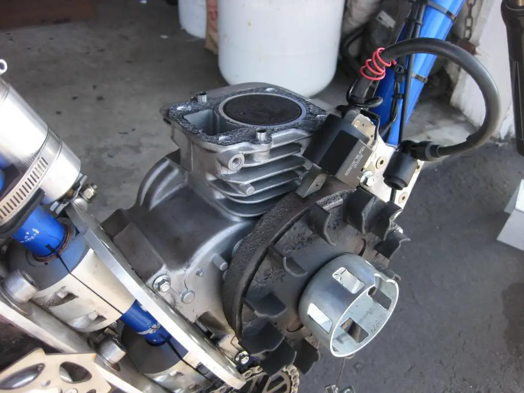

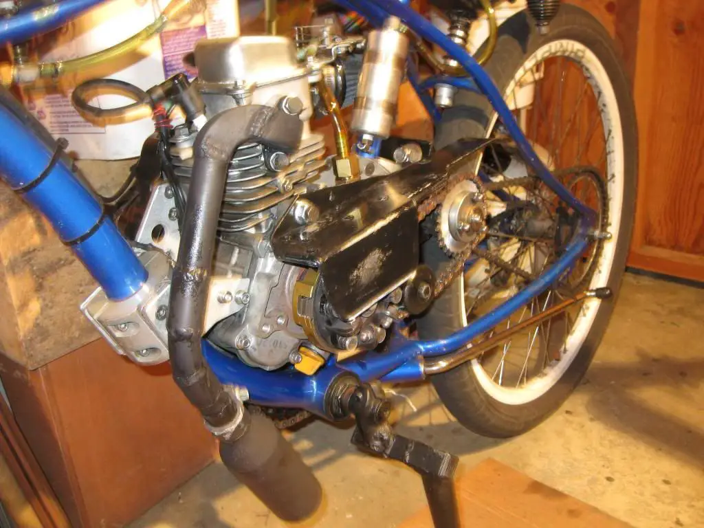

Oh, forgot to show pics of the day.....yesterday.
The bike is up and running again and sounds crisp and snappy!
Gonna take it for a spin right now........be back to talk about it later.....

Had the day off today and did a lot of riding with the new performance parts installed and I must say...... dance1
This bike has got some get up and go now.......43.5mph @ 6,800rpm with much better acceleration at any speed. My ultimate commuter bike is frisky as all heyell! So much fun to ride.

Cool. What performance parts did you add?

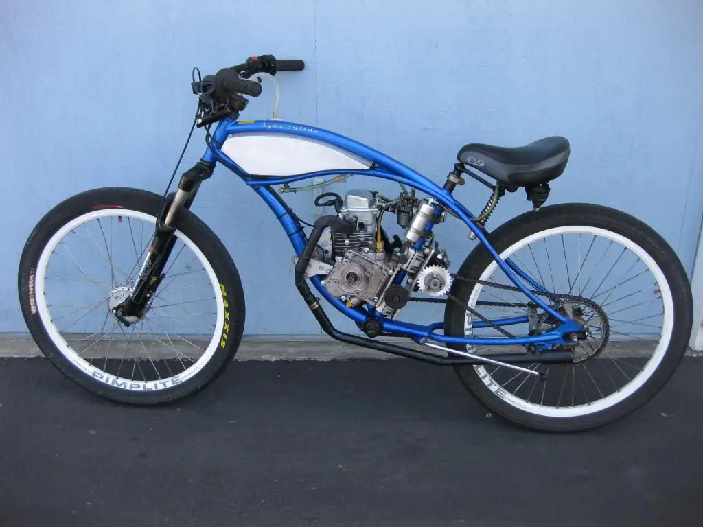

One is quite obvious in these pics I took today and the rest hiding beneath the plain exterior. Heavier valve springs, a billet rod, a billet flywheel and ???
The little Dyno cruiser is ready to battle the big, bad race bikes at Grange in a couple weeks. In the meantime, I'll be riding it to work everyday.......
pushing 5hp........maybe? see you in da pits
