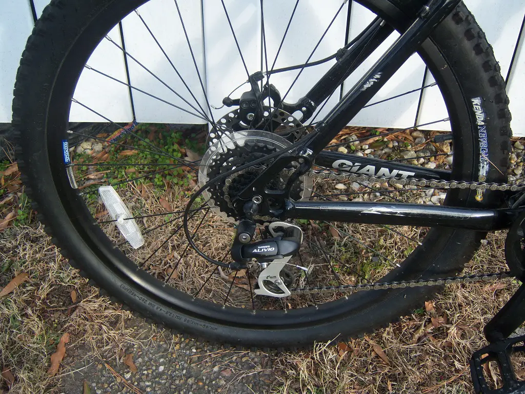

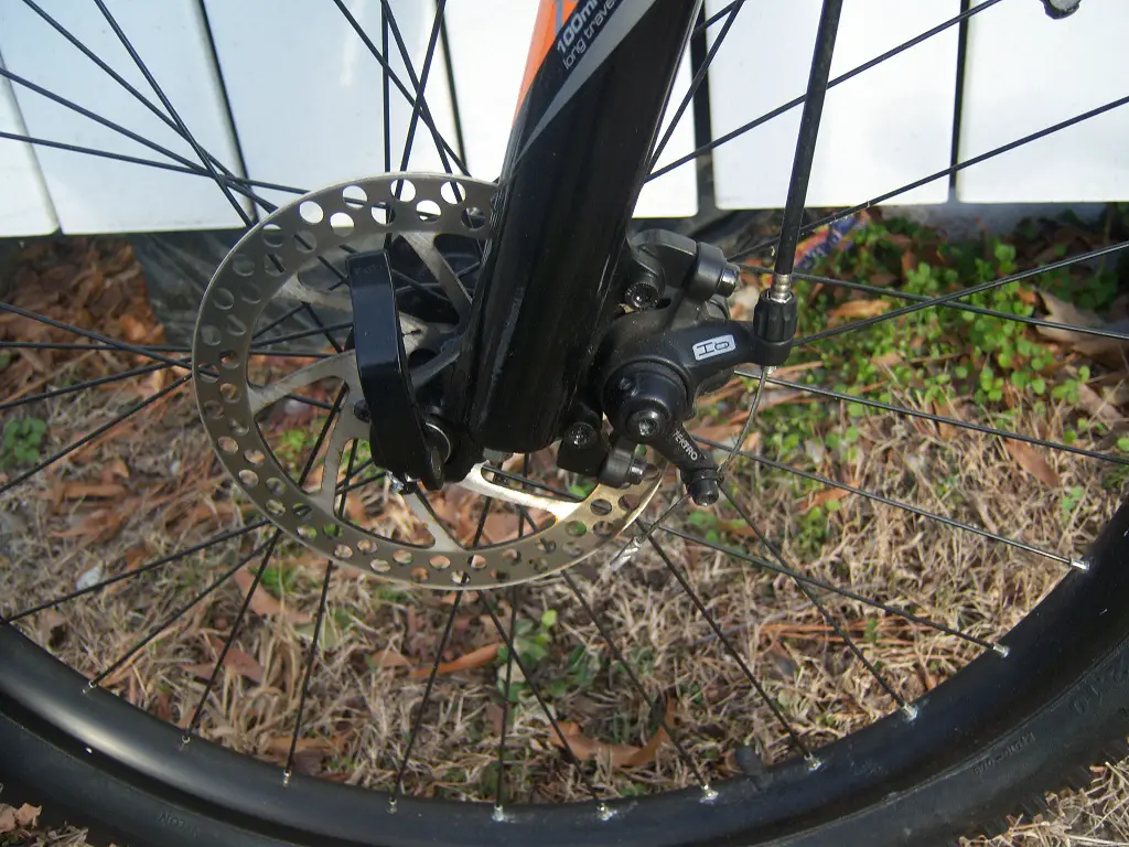

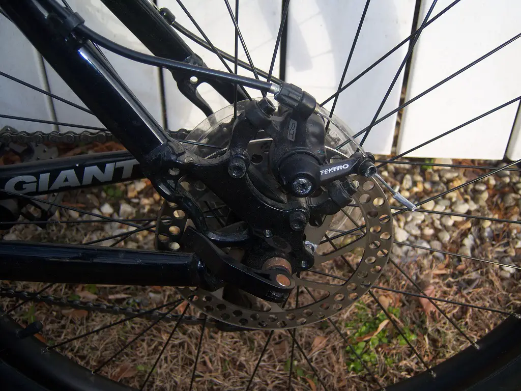

Here are some picts of the bike i want to use for my build. As i stated im a big guy 6'4" 320lbs any suggestions would be most appreciated

I prefer steel frames but that Giant should be plenty sturdy. If you use a frame mounted two stroke kit, plan on getting an oversize (diameter) front motor mount or build one with a muffler clamp.
I would assume that at your size that you will be installing a shift kit to get the most out of the engine.

I think that bike will suit you fine, I see no probs what so ever. Sturdy frame.....good brakes....go for it! A shift kit would be a bonus for ya......now or later.
Thanks for all the input. Im new to the whole mb thing. i actually brought the bike according to my height and weight from a local bike shop so no woories there. any input on the best place to order a 66cc/80cc motor, shift kit and so forth.
i got my first motor kit from bike berry no complaints. i got my second from spooky tooth. both were the 66cc/80cc motors. the first was a flying horse, the second the grubee skyhawk angle fire head. the flying horse was a decent motor till i decided to go through the sandy trails behind my appt with the stock airfilter. the stock air filters suck, i urchased a lowprofile airfilter from sick bike parts, and its awesome. the grubee i put on my trike build with a shift kit, and although i havent broken the motor in yet, it runs beautifully. Basically just look through out the various vendors. Although i must say sick bike parts has great shipping and great customer servise. Spooky has good customer service average shipping times. Bike berry well i hated the wait with their shipping but that was over a year ago. havent seen their customer service, never talked to em. umm thats my pinions, but i would suggest a grubbee, i have read posts about the angle fire not being better than the stock 90 degree plug, and vice versa.
Just a tip that I give most new people. Purchase your engine and install it per the instructions. If you have never installed one of these engine kits and attempting to add the shift kit at the same time is a lot to bite off. Your rear disc brake will make installing the kit with the left side drive a challenge and may not be worth it. If you could find an old used rear wheel without a disc brake would be optimum. I helped a guy install a 2 stroke and a shift kit on that very bike and it rocks, it is an excellent platform. The only odd thing is that the downtube is a strange triangular oval. Our universal front mount works well but needs a little tweeking to fit perfect. I can help you with it.

I got the same bad habit not taking pictures of projects. Did want to know if you guys used a shift kit and if you changed the rear tire or did you use the rim with the disc brake
Definitely used a Shift Kit and maintained the rear disc. But in your case I would recommend getting an old rim that you can use to install the standard left side drive sprocket to break in the motor and fine tune it before installing the Shift Kit.
