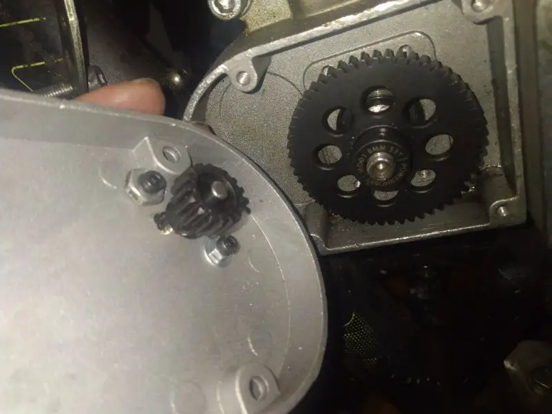

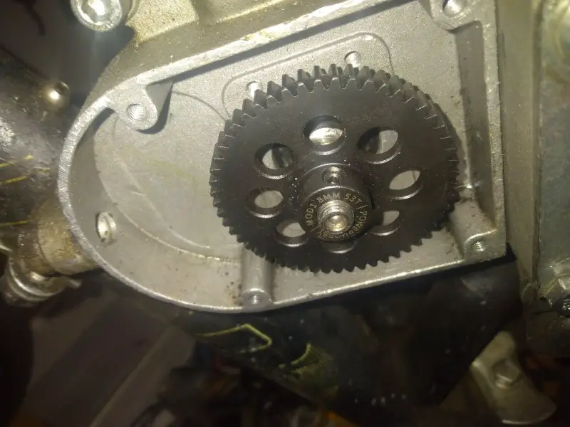

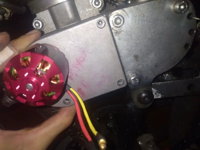

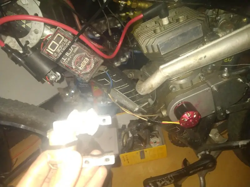

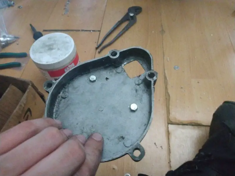

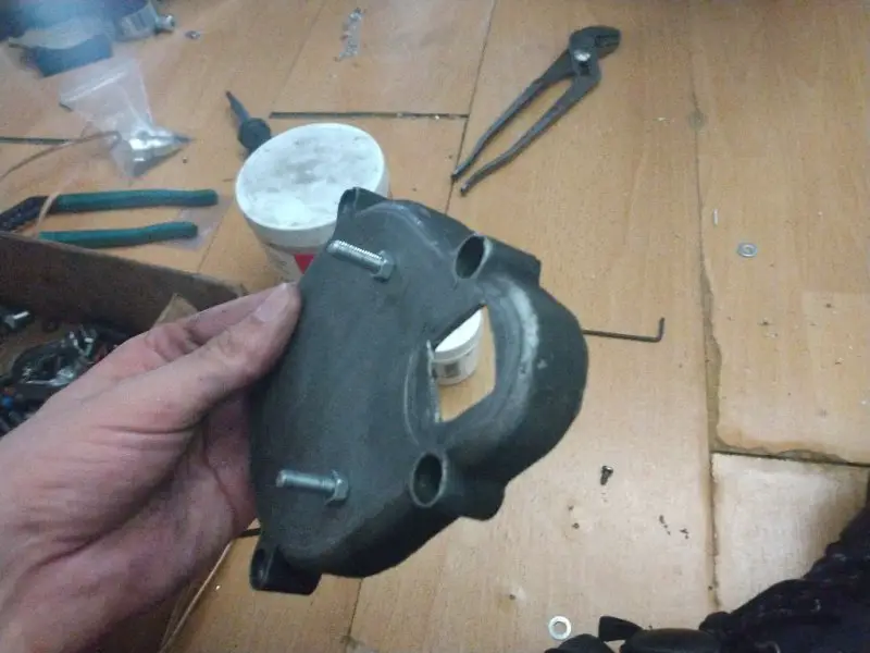

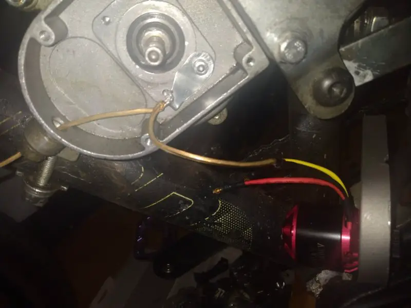

This is my test of actually using a brushless motor as an 3 phase alternator... 1 ground a/c 1 spark a/c and 1 accessory a/c
You can see my ground wire looping inside for spark
And a second test cdi I had laying around just in case it fry's like grilled cheeseers... :)
It is spinning the brushless motor with hardened pinion gears I will test and see if she lives when no rain

Hmmmm I'm not sure I figured a brushless motor is the same concept as the coil we have for stock magneto, a spinning magnet with a 2 phase coil ....
Brushless motor has magnets that spin around a steel bundle with copper wire..... I couldn't get my first test here to run I'll try a stronger/more expensive/more well manufactured brushless motor coming...... The red one was el cheep ooo motor
I thought that the bbr cdi would control the timing ? shouldn't it?
Say for example the big gear is 4-1 on the small one it should fire 4 times per rpm or 16 times... ???
I would get a 72cc 2stroke generator... And have separate engine for the wheels and electric power a trike would be easier...
It will be hard to do, the bbr cdi is built on the same concept as the stock cdi, it uses the magnet. Inside of the cdi resistors, diodes and a capacitor, once the capacitor is charged the "surge" of voltage when the magnet rotates by the coil triggers the discharge. There's a old thread here on cdi building, I built a couple about 10 years ago, it's called "roll you own cdi" you can learn a lot from that thread.

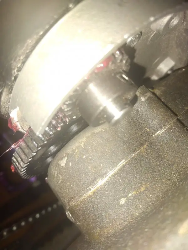

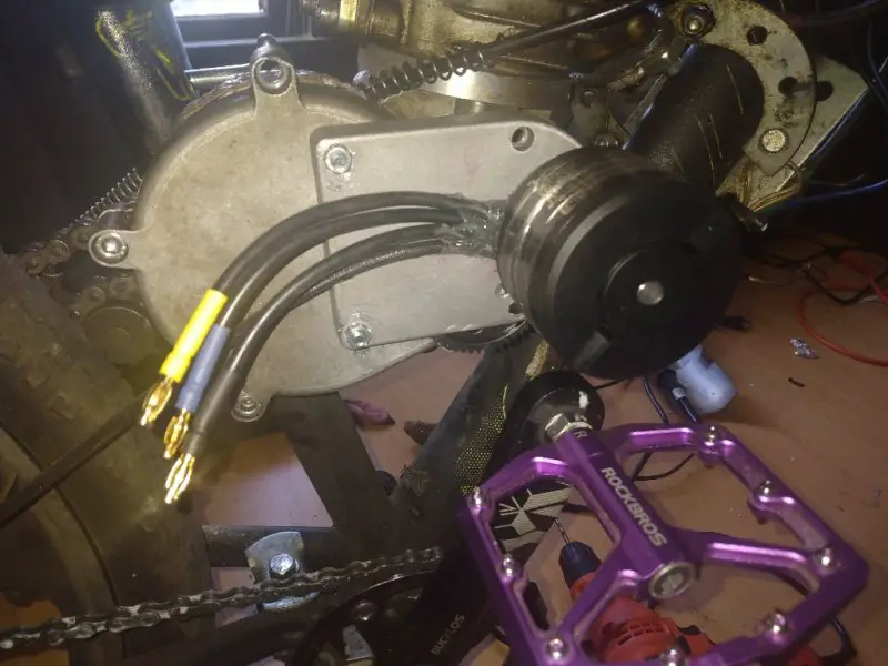

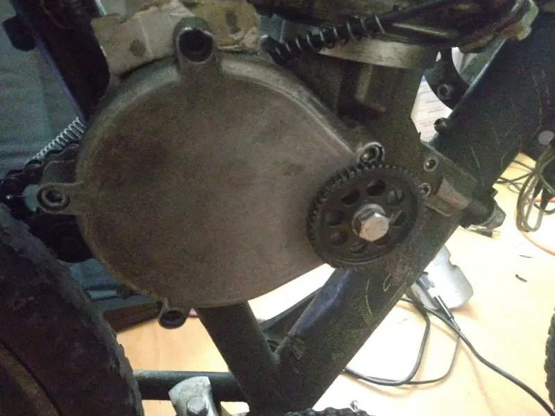

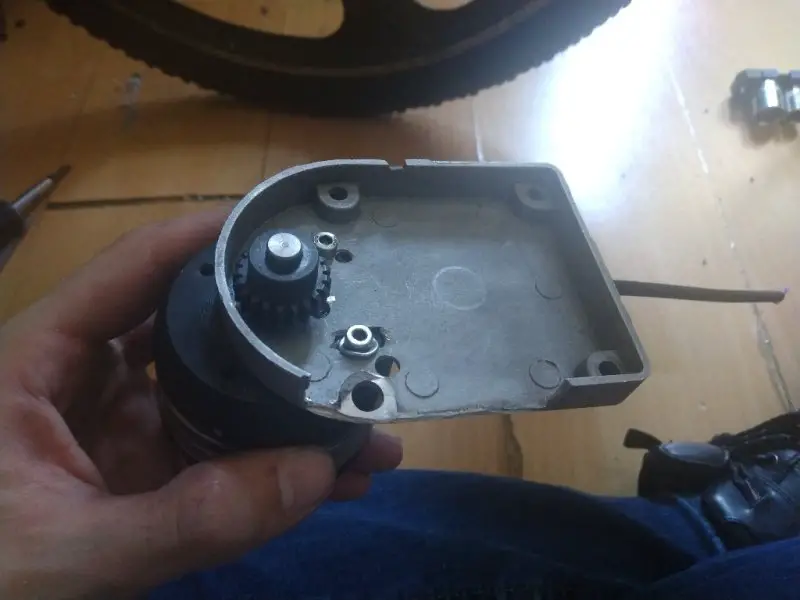

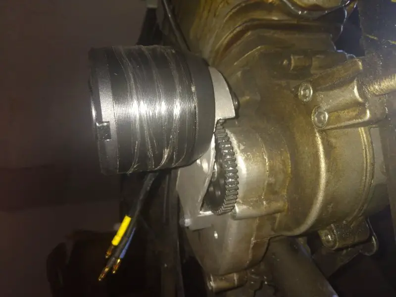

OK I put my stock coil and cdi back on, I changed the pinion gear to other side with this new skateboard motor with the pinion gears and a extra magneto cover as a short L Mount... :) I think this the winner
Just enough pedal Clarence..
This brushless motor is 3 phase
