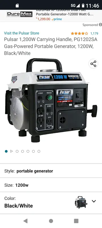

Trying something like this may be a better option, it's a generator. It will probably need a regulator and a battery, they have been on eBay for a while but I haven't heard of anyone trying one.

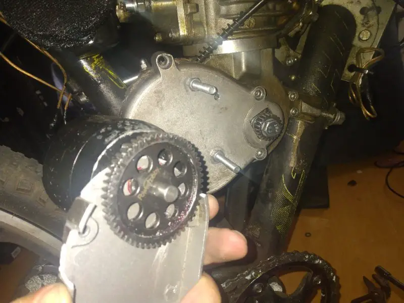

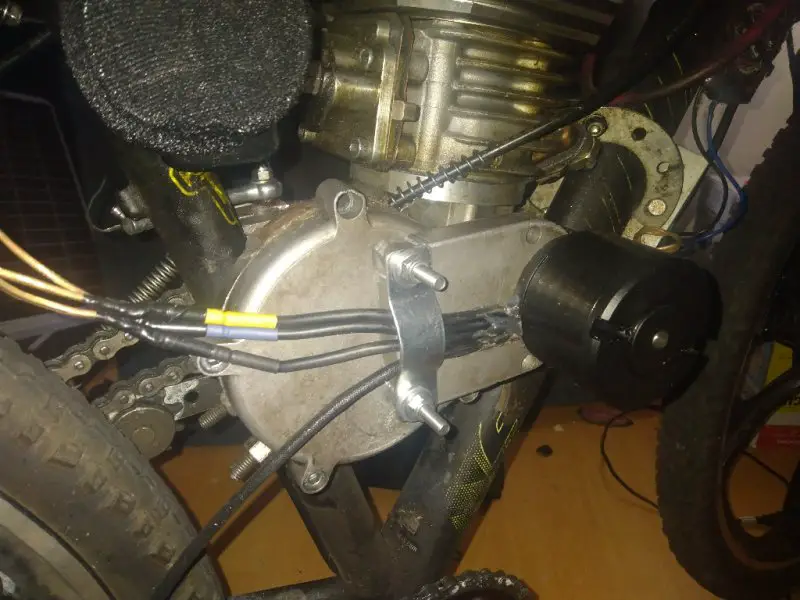

To much force broke the aluminum magneto cover I was using as a Mount....... I need to other re gear the Small gear to reduce friction or use a smaller brushless motor ..... the one I have now has a 8mm shaft
I've had one of these generators... It worked great when I was off grid and it's small enough to carry just about anywhere... So you have one fuel for both and not have all your eggs in one basket

Re gear big on brushless motor Small on shaft.... I'll see if it runs better, I did have to make another Mount with a magneto cover 0_o I'm running out of magneto covers!!

^True I might do that with my next build with a bbr magneto cover, they thicker!…… this brushless motor is 2lbs or more, I think gearing is the key here, I'll fire it up when it stops raining all week.
