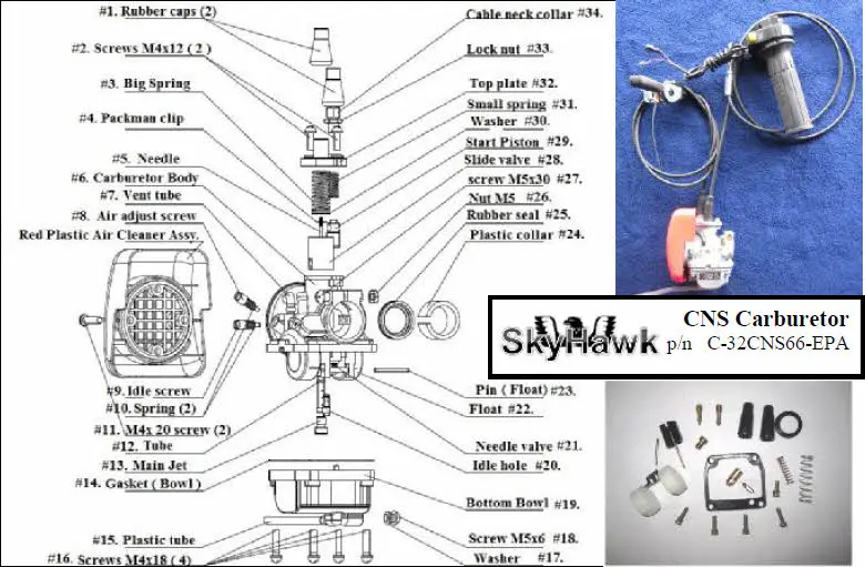

Sounds to me like you tweaked (bent, kinked or otherwise screwed up) your throttle cable while loading or unloading the bike into the car. Either at the handlebar end or at the carburetor.
Remove the air cleaner, doesn't make any difference which carburetor you have, and look into the throat of the carb while twisting the throttle. You should see something moving up and down as you twist. Up as you increase throttle position, down when you release it. If you don't see this, look for the reason.

Also, thanks Tom, I am going to try and do what you said. Unfortunately, I have taken the word noob to a whole new level when it comes to motorized bicycles. I don't even know which part is the air cleaner.
Thanks, I checked it out this morning, it seems to be moving up and down now. I think it might have been jammed. Frankly, I did nothing to fix the situation, just took a look at it this morning, and it was working.
