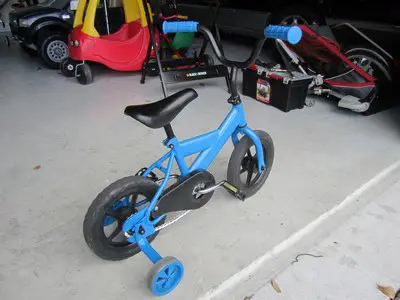

I am embarking on my second paint job prior to the big one. What I mean is, I am painting another one of my kids bikes before I do the "real job" of painting by motorized baby...
Anyway, I am painting it yellow and black (engine paint rattlecan) and was thinking of a color fade on the frame yellow (front) to black (back). Anyone have any advice for even the most ghetto of efforts?
Not trying to be special, the recipient is 5 and not picky, but I'd like to to look decent from a few feet away at least...
For ****s and giggles, here is the first paint job on my 4 year old's bike...

I think it turned out pretty well after all - I found some flame stencil stickers and used them instead of the fade idea...
The paintwork looks dandy!
I'm SURE your 5yr old is REALLY happy with it! lol
