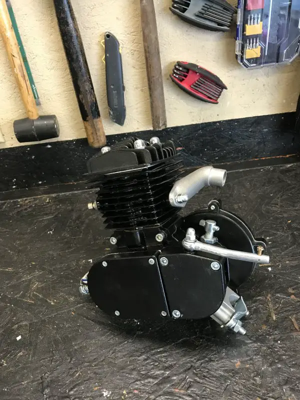

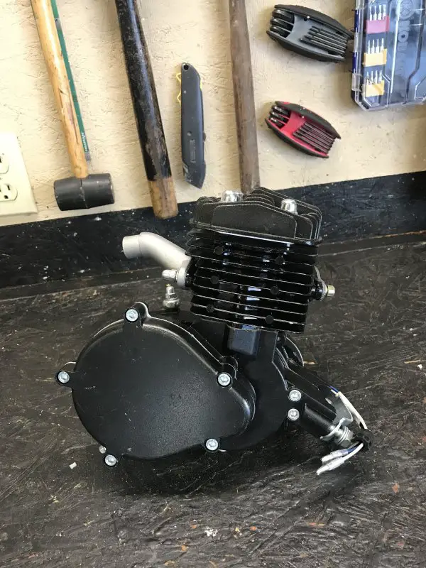

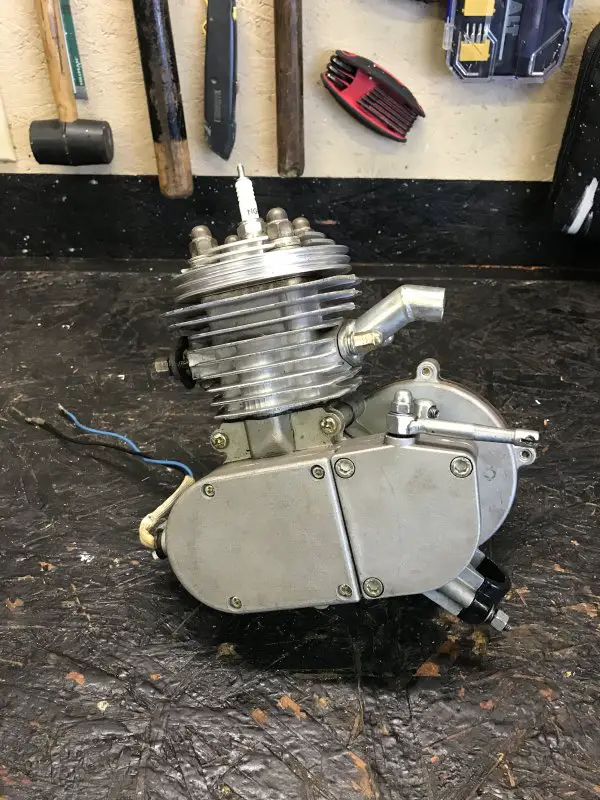

If you want a painted engine do it yourself, don’t buy one already painted. I got a engine delivered Thursday that is painted, after taking it down to clean up the ports and true the head and cylinder I found paint everywhere. Paint was in every port, including the transfers, paint was on the piston too. The head of the piston was black along with the top edge of the cylinder above the top piston ring. I got it all cleaned up and back together and ready to install, on a future project.

I haven't bought a fully painted engine before Greg, but I have bought cylinders that were painted and they had paint all inside like you described lol..!

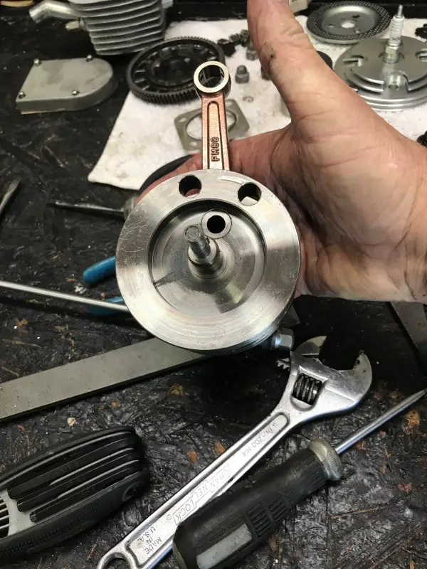

Have you ever tried to drill and balance the crank better?
Im gonna give that a try on an engine I have that I know has horrible vibes to see how much difference it makes.

I remember a while back seeing the video you sent me the link to, I’m probably going to bolt this engine on a bike and try it. It has the open trench style transfer ports, They seem much better than the earlier style. If mine needs balancing I’ll take it down and give it a try.

thats a very nice clean looking engine sir.

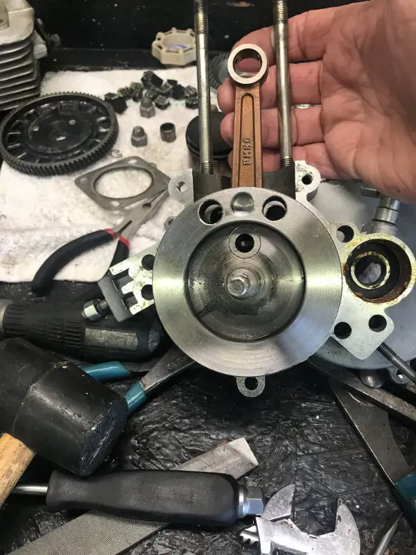

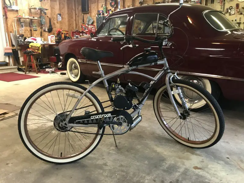

I put the engine on the cranbrook I had a GT5 type 38mm stroke engine on, this 40mm stroke engine is very smooth. It gets into the 30’s straight out of the box with a 38t sprocket, should get better after a while. After it’s broken in I’ll be able to compare the two, right now the gt5 is much faster, but the new engine is much smoother. I’ll take smoothness over a couple of mph. I’ve already started taking the gt5 apart to balance the crankshaft, I’ll then install it on my main bike with the 44t sprocket and see what the vibration is like, I had it on that bike before and it was bad, I’ll know fairly quick if the balancing works. Since it’s on a cranbrook I set it up so my car makes it look better.

Speed is not a problem with my gt5, it's the vibration. I've been 40 on it but hated ever second, the new 40mm stroke engine is so smooth, if it picks up a little more power after break in I'll be happy. 31-32 right out of the box with a stock gutted muffler and a bofeng carb.
