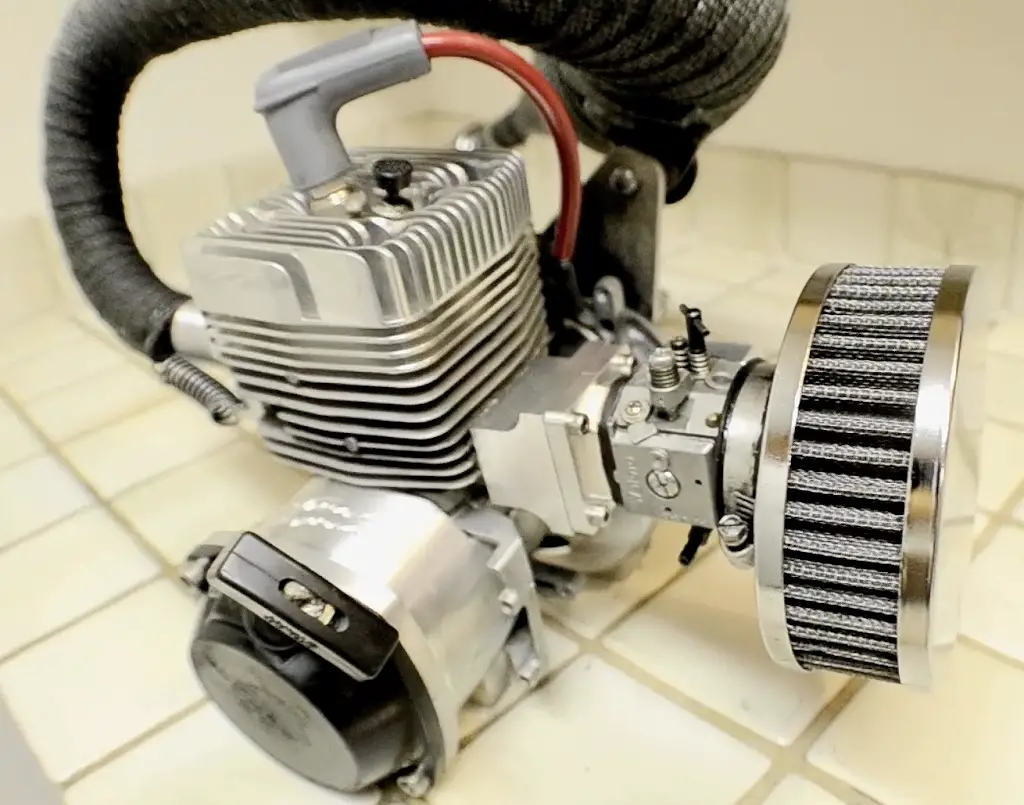

So... Decided to build some killer standup bikes.
Using the venerable GSR frame, and on this first one I've got a ultra rear $2,000 Trevor Simpson 62cc modded motor, ported by chris bartolone
http://www.youtube.com/watch?v=630RrSot_C8
http://www.youtube.com/watch?v=br7I9vDQJXA
SPECS:
TS 60 Head kit race / compression release valve
TS60 2x carbon fiber reed valve
TS60 throttle linkage
TS Outer casing
TS exhaust header
Ful porting throughout motor
Eton fan cover and upgraded RC coil/ rpm limiter removed.
MSD plug wire w/ champion plug
Custom Bartolone racing pipe with heat wrap and a carbon fiber silencer,
K&N Filter, delrin intake spacer (heat shield) and one **** of a CARBERETTOR, with a 1/2" velocity stack..!!
15:1 compression dome, runs VP red 110º race gas with Maxima Castor 927 @ 25:1 ratio..
Estimated over 13-15HP

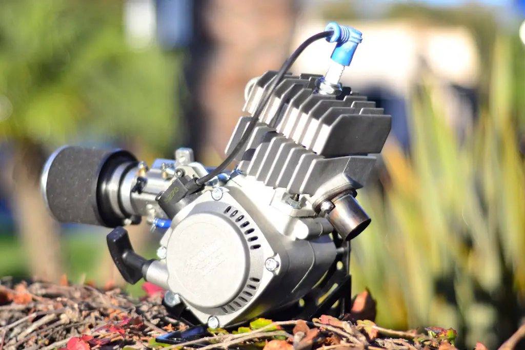

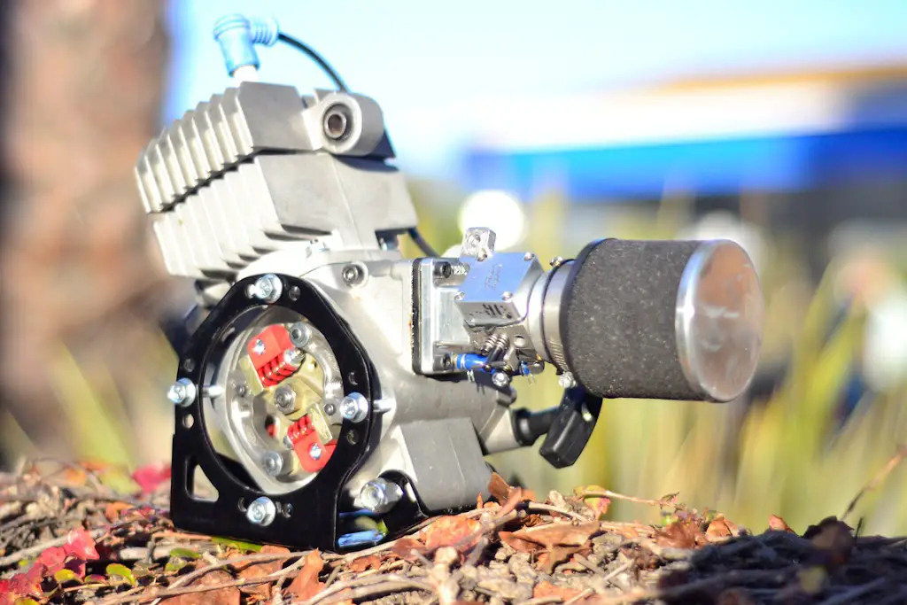

Here's the Italian Polini engine, this is a brand new 5 port, with a black race crank (impossible to get) and a bunch of crazy mods. Same exact setup that won the world championship.
Also putting it in a GSR frame. This'll do 55+mph and wheelie off the line. Should be a bit faster then my 13+hp Morini 50cc street sprinter bike.
