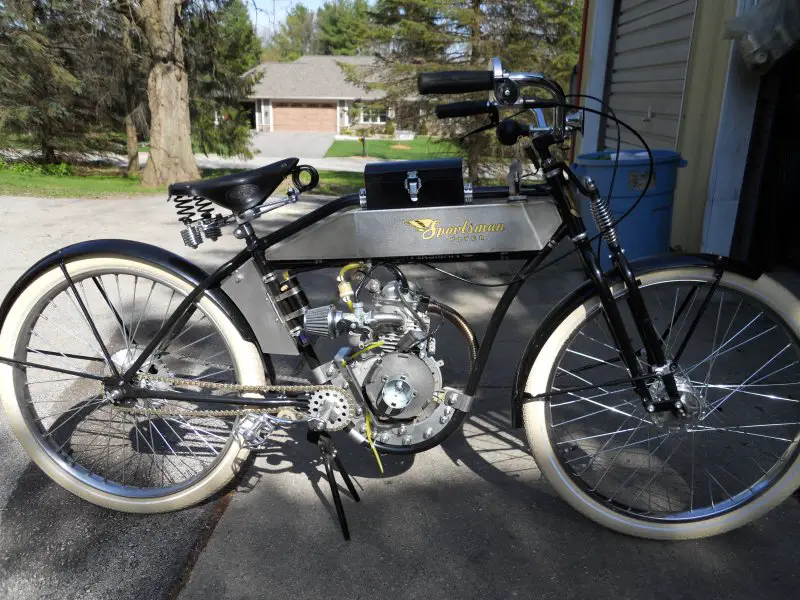

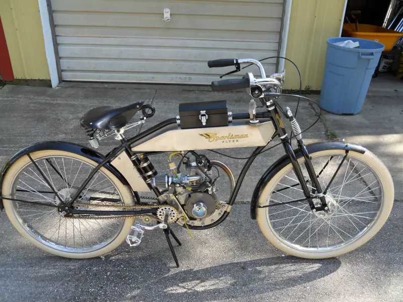

First build Huffy Davidson Just to establish a stable rolling speed. saved the BBR clutch.

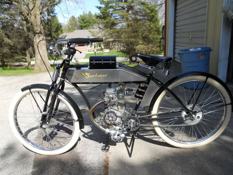

Build #2 a Sportsman Flyer 80 with a Bully GoKart clutch probably does not need the pedal start.
Other better and wiser builders, I hope will guide you in your 4cycle build.

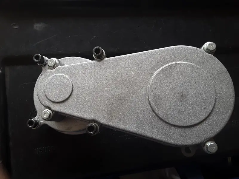

I did mention I am around 240 pounds and have 2 bikes with the 49cc one with 36tooth and one with a 40 tooth sprocket. I haven't had any issues with the 40 tooth with really fat tires. The 36tooth got up to 30.44 on my GPS before running out of space, haven't checked for top speed on the 40 tooth. Another tip if you are gonna get a 4-stroke, do NOT get one with the smaller pocket bike transmission. This POS, I have had a couple crap out on me.

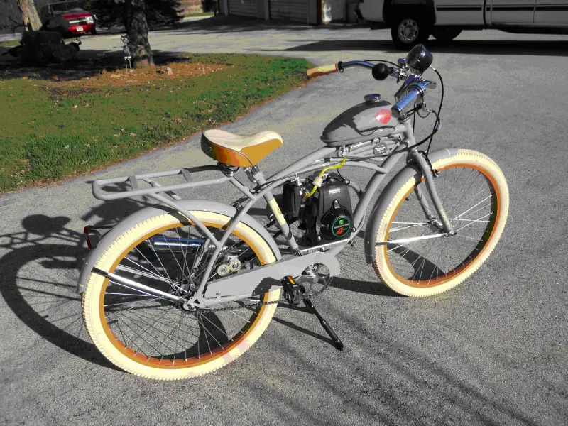

The 212 engine on my cruiser project looks trim and very pretty with shroud off, exposing its shiny scalloped billet flywheel.
One day my shoe's gonna grind onto the fan blades.
And those blades spin up to 7,000 rpm!
My shroud stays on.
Since eliminating the pull start, I'll install a 7" circular plexiglass window to showcase the flywheel.
FYI, I'll have an electric starter PLUS a cordless drill to spin the engine.
