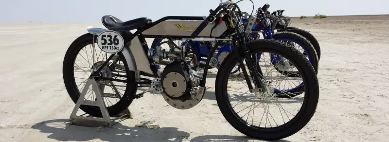

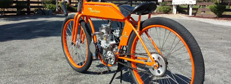

Fan shroud and striped both, he builds a lot of bike and races also............Curt
