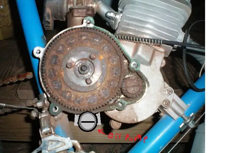

Okay everyone! Here's my proposal. I have been researching my butt off the past few days and I decided it is perfectly possible to do an oil injection system on a bike so there is no more premix and you can fill up anywhere. Here's how I plan to do it. Basically an oil pump for a two stroke needs to be driven by the engine in some way so that the pump is actually moving oil. There is also a linkage that is operated at the same time you twist the throttle so that your engine is getting more oil at higher rpms and so it doesn't run dry on hills. The pump I plan to use is this one Oil Pump Assembly because I feel it will fit nicely under the engine in the place that I imagine. I picture cutting off some of the clutch housing so that I can take a small bevel gear like this </title> <base href="http://www.bicycle-engines.com/"> <meta name="description" content=" - 2-Stroke Engine Kits,4-Stroke Engine Kits,2-Stroke Parts,4-Stroke Parts,4-Stroke Engines,2-Stroke Engines,GT Series Bicycles," /> <meta name="keywords" conten with the exact same number of teeth as the other small bevel gear and put it on the shaft of the oil pump. I have figured out since the small bevel has 24 teeth and the big bevel has 80 or 82, that it would drive the pump at a ratio of 4:1 off the big bevel. This would however mean that it is actually turning the pump at an equal rpm to that of the crankshaft. I know that this is not an insane thing to do because the pumps on tomos mopeds are directly connected to the crankshaft, these pumps pump very little for the speed they are going. Most motorcycle autolube systems run at a ratio of 3:1 or more, so I know this will be fine
The easiest way I have found to deliver the oil from the pump to the engine is to make a system just like this http://www.dansmc.com/yam_autolube4.JPG This is a very easy system where the oil is simply fed directly into the intake manifold and pulled in with the suction of the engine. I will install a checkvalve on the intake manifold to prevent blowback, as air bubbles in the lubrication system could prove detrimental to the engine internals. The picture below is a picture I did on pain with my laptop track pad so don't make fun of my drawing skills
Also, the rusty clutch was the best pick I could find
