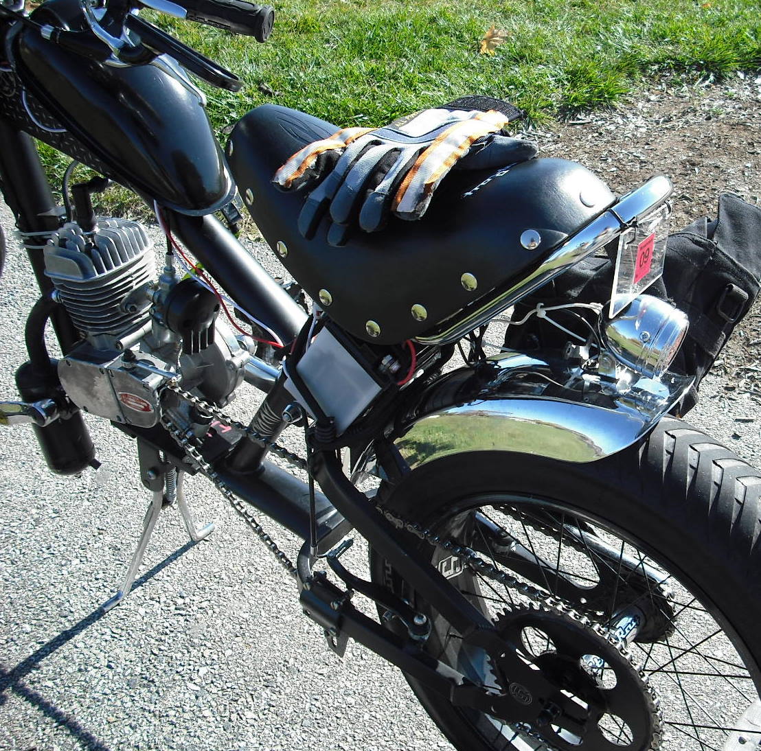

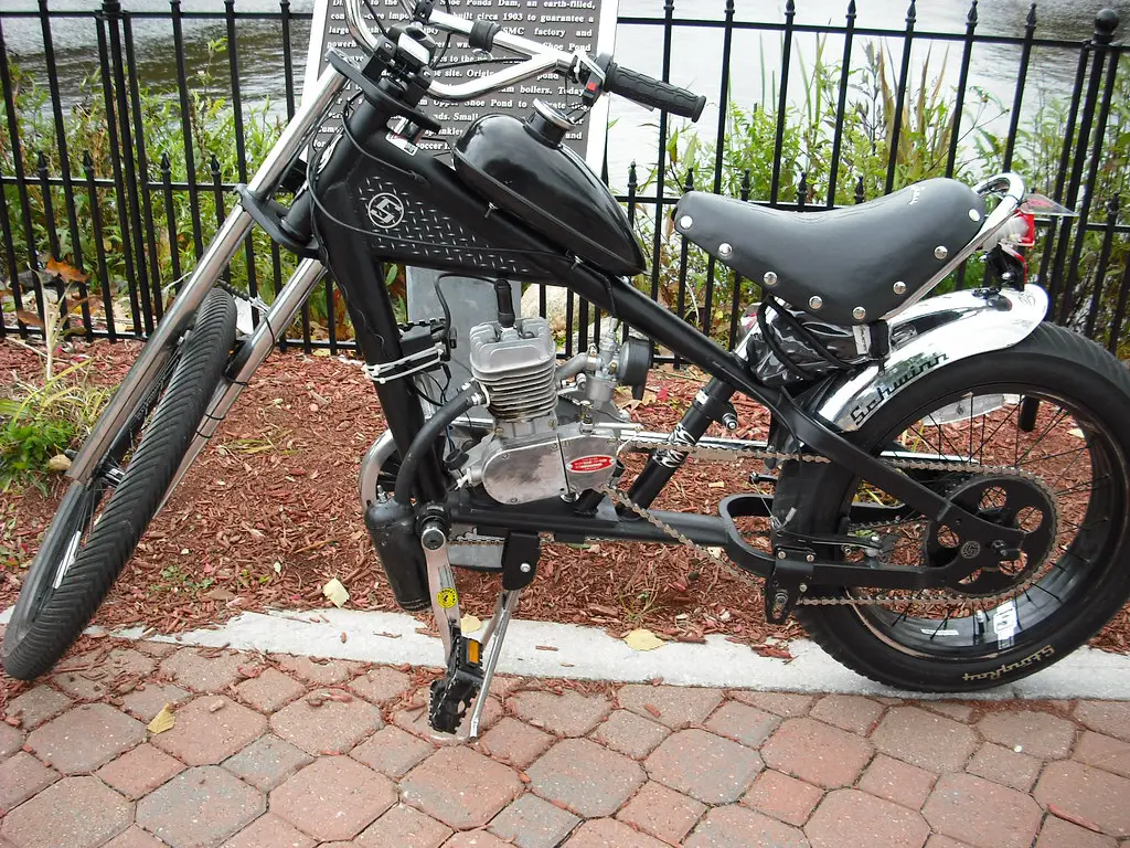

Side view of engine mounted on bike. You can see where oil spit out of it when i had the old crappy gasket on there, you can also see the new good gasket that I made.
you can also see the different polishing marks on the side of the engine- the metal has different densities and no matter how hard I tried I could NOT get that thing all one even tone... Tick me off. I will probably wash it all down this winter and spray it flat black.

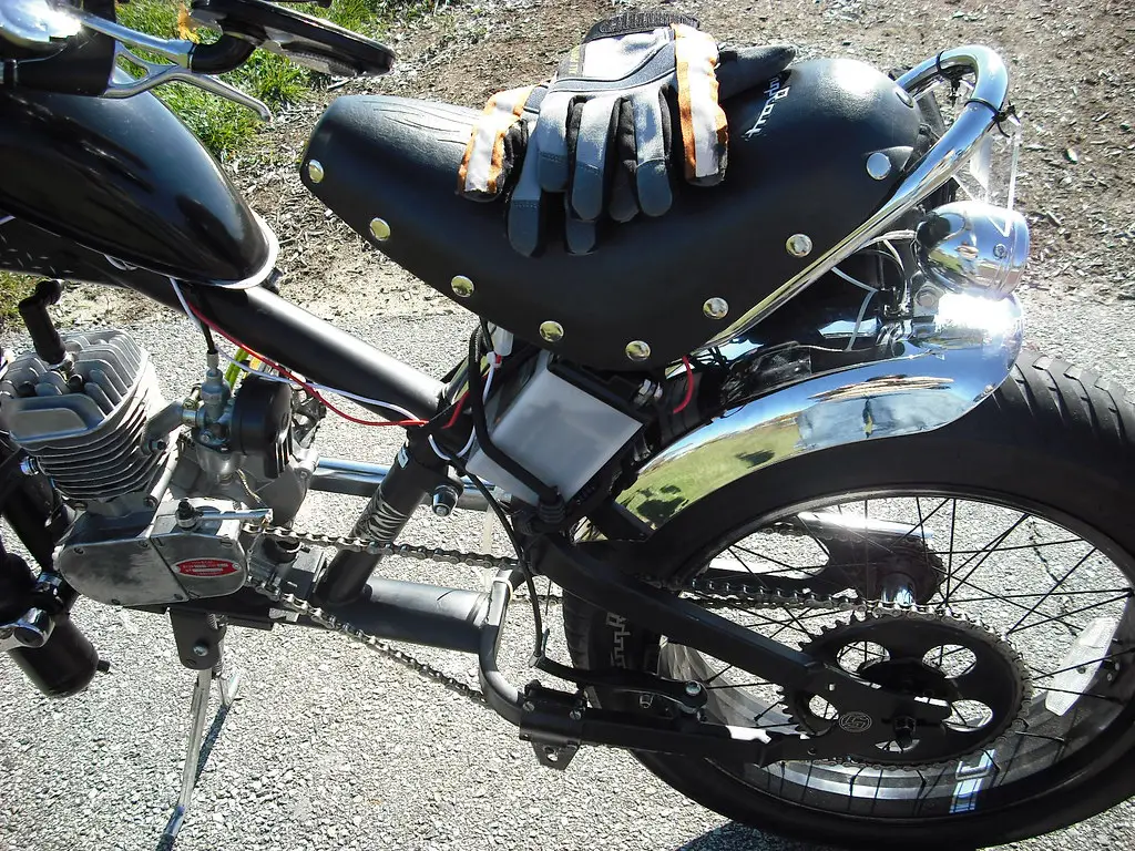

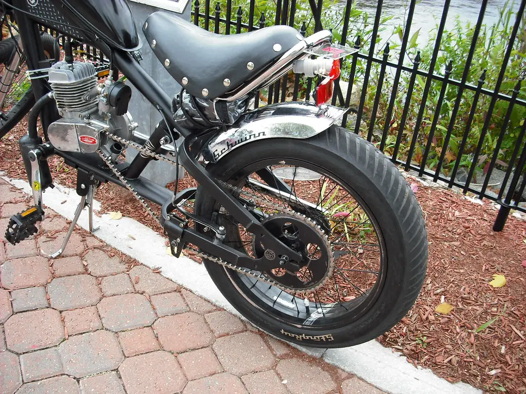

Here you can see the chain, sprocket and tensioner.
I am using an OCC stingray chain for the engine side as well as the pedal side. I think it might be sweet to get a black chain.
I need to repaint that sprocket. it got all scratched to heck in the first couple of test runs on the bike.
Oh yeah I finally got the fender cut, I cut both sides so that its symetrical. I notice inteh pics I missed a sticker... one on the fender... I'll get that puppy off their asap.
You can also see my ghetto rear light- a reflector popped off its backing, 4 holes drilled, zip tied to a 3 led flashlight and ziptied to a rear reflector bracket attached to the actual reflector.

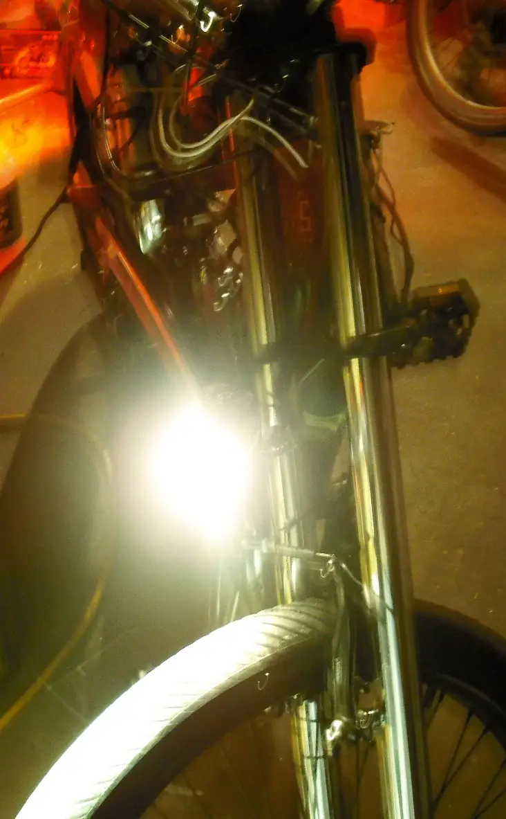

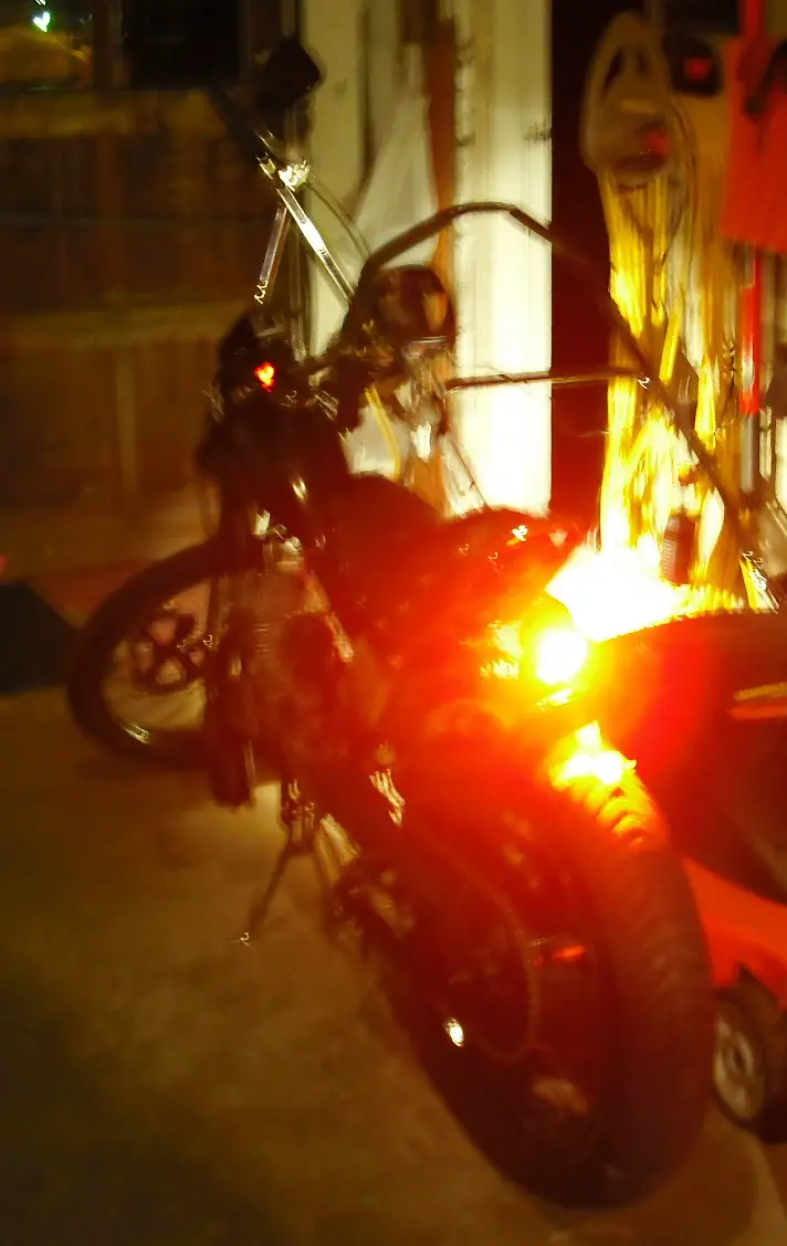

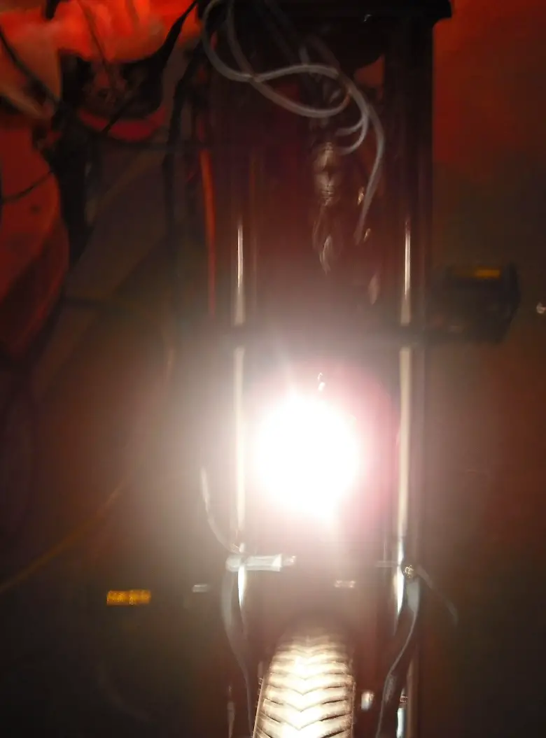

I started working on the lighting system on my Stingray. I picked up a set of fog lights at wally world for $15, a 12v motorcycle battery and 2 12v LED lights for turn signals. There should be a post somewhere tell you that if you buy a lead acid battery in Mass that you will have to pay a $10 fee. The battery was $27, plus $10... GRGH
Wally world did not carry a battery minder, target does, a Duracell over night charger. There are 3 options for wiring it, each has a jumper that plus into the minder so you can hard wire it, use it as a jumper or plug it into the lighter on the car, it was $20. I figured that it would be cheaper than ordering one from online.

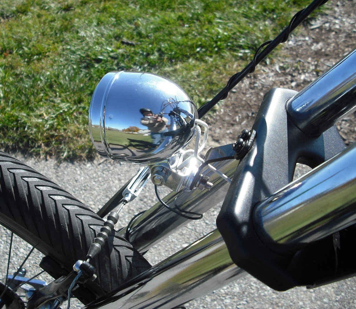

I mounted one of the fogs lights to the front as a headlights and cut a tail light reflector for a red lens on the tail light and mounted up the other on the rear.
I filled up the battery and charged it. And have it temporarily mounted under the seat, it don't like it much there but for now it will have to do. I'll see about getting some sort of side bag for the rear of the bike to hide it away. I also need to get something to cover the wires. The lights came with various multicolored wires that are somewhat ugly. Next paycheck.
I'll get a few pics later.
I did get a quick test drive in, and found the lights to be super bright. I have to put the rear light very low and also the headlight must be kept low. I'll have to take it for the ultimate test a little later and see how it looks.
Well these aren't very good pictures of the lighting set up but you can sort of see how well it lights things up. I'm going to swap out the bulb in the tail light for something a tad bit smaller, I don't need 50 Watts in the rear, maybe 10 or 15...
Wiring was dead simple. 1 wire to ground, 1 wire to switch. Lights in parallel so if one dies the other doesn't. Battery is tucked under the seat for now. I'm going to get a ammo box and mount it on the right side of the rear tire and put the battery in that, it will off set the weight of the engine. For now the battery is fine where it is at.
These little chrome bullet lights are great too, compliment the bike and really light up the road.

front light:
Rear light

I got a few pics of the lighting set up. It's super simple and easy. 12v battery under the seat, switch up front, 2 lights in parallel.
Front light and me
rear light and battery

SHOES, SUPER NICE BUILD. I BOUGHT A NICE BLACK ONE LIKE YOURS ABOUT A MONTH AGO, LOW SERIAL# HE SAID , I NEVER LOOKED. IT WAS SMALLER THAN I EXPECTED (I`M 5 FT 15 INCHES TALL) BUT THEY ARE SO COOL AND IT IS LIKE NEW FOR $75. MINE HAS FOOT PEGS AND NO FRONT BRAKES. DID YOU USE WASHERS OR THE RUBBER SPACER TO KEEP SPROCKET OFF THE SPOKES? YOUR CHAIN IDLER LOOKS LIKE IT WAS MADE FOR THE RETANGLER CHAINSTAY, WHERE DID YOU GET THAT ? IS THE IDLER WHAT KEEPS THE CHAIN FROM COMING OFF? DID THE NEW INNER TUBES WORK OUT? I READ YOUR COMPLETE BUILD TONITE. WELL DONE. NOW THAT THE $60 SPROCKET ADAPTER IS OUT, I AM RETHINKING. RON .trk
They do look larger in pictures. Mine has the front brakes and not the foot pegs. The pitch of the spokes is steep so the sprocket barely touches them. I did use 1 rubber spacer on the front.I had toi drill new holes in the sprocket that aligned with the flange on the hub. It was not hard just time consuming. I have pictures on my flickr account (link in my signature).
The chain idler: I bent it to fit and flattened the curves with hammer then painted it black. It does not keep the chain in line, the engine is moved as far to the left so that it is aligned with the sprocket. Barry's mount made that possible. And it was a pain to line up.
