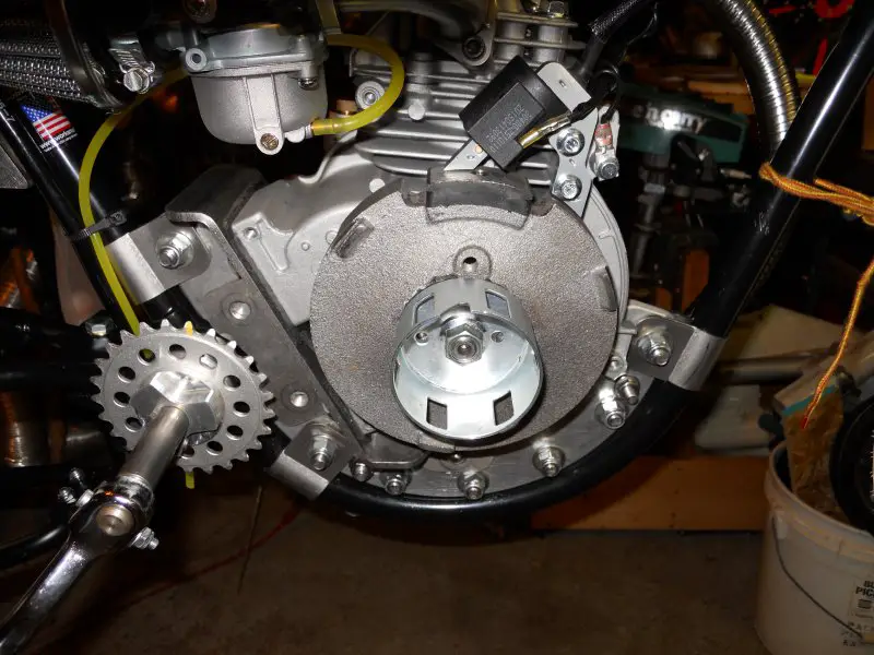

I have searched long and hard for an aluminum billet flywheel for my 79cc predator engine. Too many stories about shattered cast iron flywheels.
First thing I did on my Sportsman Flyer 80 build was split the engine case and remove the governor.
All I have found are finned ones. When you are going 30mph fins will just shred your pants leg. "What I want to replace."
Today Sunday, I searched Go Kart sites. Still no luck. Seems 212cc is where high performance manufactures provide options. Granted it is a small market. Sure will never see a billet flywheel for a Huasheng. A large undiscovered market.

A little searching yesterday AGK had a photo of a billet 79cc flywheel. So I looked in the performance part section. Nothing there? So I sent AGK an email.
Got a reply that they do have them made but in limited quantity's and only if they do the installation as the crankcase has to be modified for adjustable spark timing.
Here is the link.
https://affordablegokarts.com/colle...roducts/modified-79cc-predator-engine-stage-1
They also have a stage-2. Not cheap but Pat Dolan says it is worth it performance wise.
