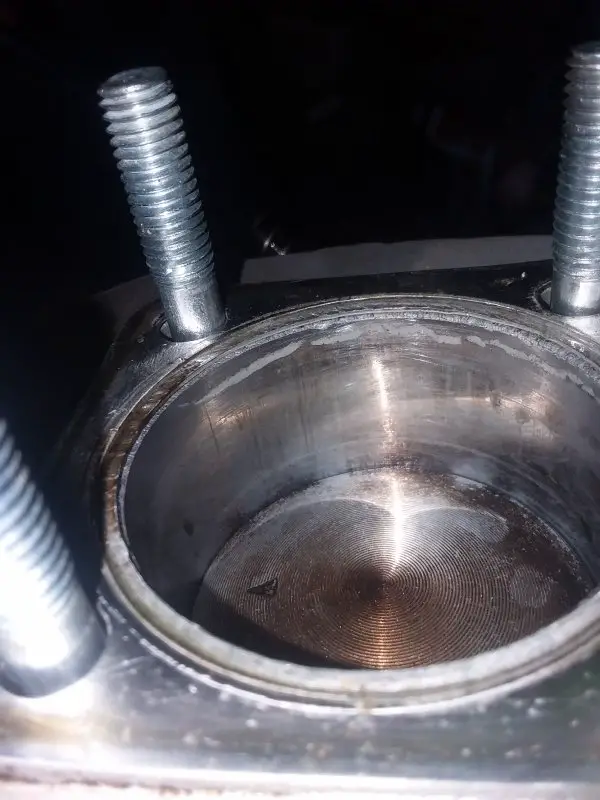

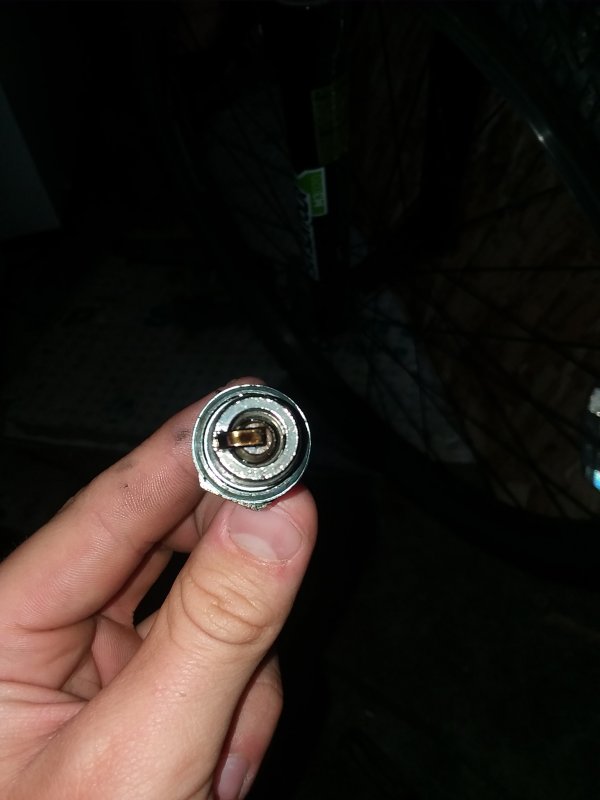

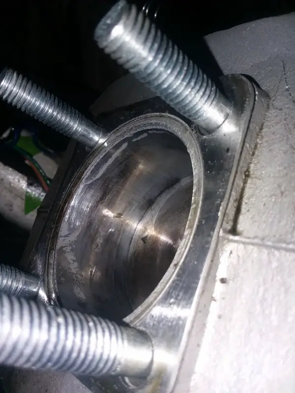

I'm new to this I bought a kit on eBay for 100 dollars and I have it on my bike and it revs up fine but when I try to ride it down the road it can't make it up a super tiny hill and it starts jerking bad. If I pick up the back wheel and disengage the clutch it revs up and then bogs down to like mid throttle. And its brand new like not even an hour on it and i took the head off and the cylinder has some scores near the exhaust Help!
Uh Oh.... Can you show a pic of the cyl. Some of the New bargain priced kits are coming through with the cylinder Plating flaked off. That does cause the power deficiency as you describe. Follow this search hopefully it's helpful.

It's not scored bad but it's got some scores on the exhaust side

Smaller main jet is only good for 4 stroking @ 3/4 throttle to full. Did you try raising the clip position so as to allow the needle to set deeper in the carb? None the less - I fear you need a new cylinder.

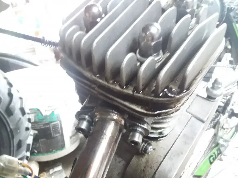

The first thing that came to my mind when you said "it starts jerking really bad" is that you might be riding it too slow!! First of all, these things run kinda bad until they are fully warmed up, & you also have to ride it fast enough that the engine is in it's RPM 'power band'... (meaning that it's gutless while going too slow).
Switch to 32:1 mix (4-oz oil per 1-gallon of gas)
The cylinder might still be good to use... Put the head back on & torque it down to 12 ft/lbs (if you torque it too much, you'll bend the head & cause a compression leak.
Another thing... PUT THE STOCK JET BACK IN IT!!! You don't want to re-jet it until it's fully broken in!

way to lean, need a bigger jet. i use some of the cheapest kits there are. just gotta run 'em rich like a chain saw. if it revs great and doesn't limit out and sputter a bit with no load at full throttle, you're gonna burn your engine up. it's running lean. a two stroke should always be running rich with no load. it's when load is applied tht extra gas gets used up or to cool the cylinder.
