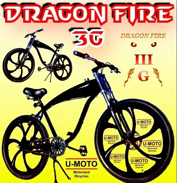

i am thinking about my next build being on one of these are they a big problem ? yes my next build will be full lazy mode possibly with a 4 stoke so I can build something more reliable for long range trips Put some front and rear cargo racks on to carry some camping gear and do a nice long trip yes i know i can do the same with a motorcycle but doing it on a bike seems like more fun

That is the same as the one I'm building, except mine has spoked wheels. I plan on getting wheels like the ones on the one you are looking at though. If you plan on using a Comet or clone constant velocity transmission, you will need to get a #420 motorcycle chain. The #415 chain is not wide enough to mesh properly with the 10 tooth output sprocket on the CVT. So far that is the only issue I have had with this build. I am far from finished with it though. I don't expect any other problems, but you never know.
If you plan on putting that much load on it, I suggest that you use a CVT, because you will most likely fry any centrifugal clutch.

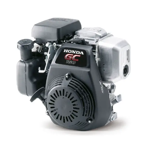

i was just looking at one of those Chinese 4 stoke kits and replacing the engine with something about the same size and power but a million times more trust worthy like a Honda CG160
