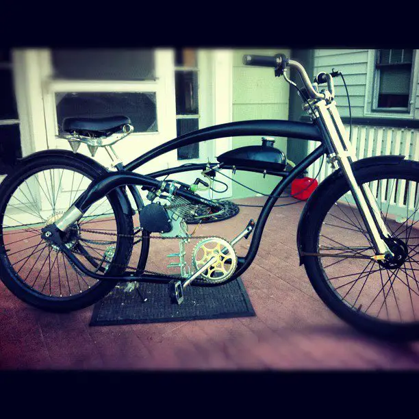

Found a stretch cruiser over the summer for sale at the beach, picked it up and immediately was eager to get an engine on it. Took the engine off a beach cruiser I had, though there were some minor problems along the way she's starting to shape up nicely now.

So I'm finally back working on the bike been a busy couple of months for me with trying to graduate college. But now the weathers getting nice and I'm missing being able to cruise around on the motorbike. So ive run into a few problems off the bat already.
1. I cannot find a chain tool for the 410 chain i keep buying the walmart ones and they just break. I was thinking maybe grind down the pin then use a punch? open to suggestions
2. Chain tensioner- the stock one does not have the height needed to reach the chain I havent come up with anything yet and am at a loss of ideas.
If anyone has any ideas I would greatly appreciate it. Oh and do you guys think one simpson strongtie is study enough to hold the engine in place ?

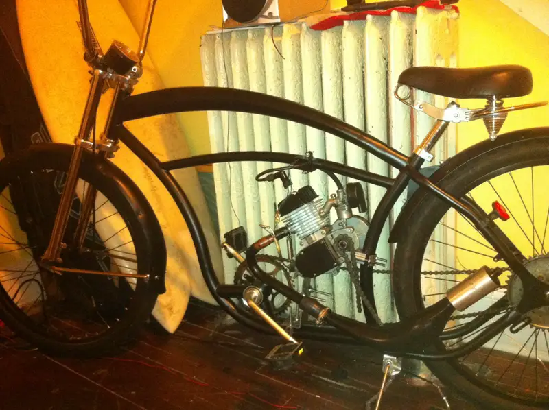

so figured out the chain tensioner still working on the brakcet with the strong ties. I found out one was not durable enough to hold the engine still when riding. The engine would begin to move to towards the sprocket side from the torque. Also mounted the exhaust a different way feel it has a better look on the frame and put on a different set of handlebars to give it a more old school feel. More to come still.
Redid the strong tie mounts using a total of four strong ties to secure the bike which fixed the problem of the engine shifting, just working on getting the clutch tightened so it wont engage so easily guessing i either need new pads since ive tried working with the flower nut and all. Work in progress but she rides nice, bit more vibration than i'm used to but with the expansion chamber i can feel a big difference in the power and overall feel. Gotta slap some disc brakes on when i get a chance since I'm using the old bottoms of my vans as brakes as of right now haha. will post more pictures soon
