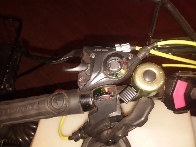

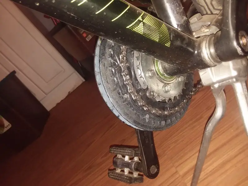

I'm sure the bearing in the shift kit would have to be replaced. Good find though. Issues I don't like with a single chainring shift kit are the cross chaining and the narrow reduction range.

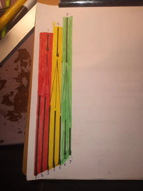

The triple chainring shift kit I use solves both of those issues. My reduction range is 66.79:1 to 16.25:1. I also use a color-coded one-hand shifting system. The only time a chainring is changed is when in either rear sprockets (3) or (5).
