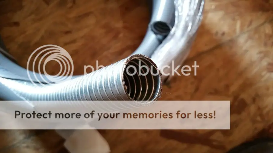

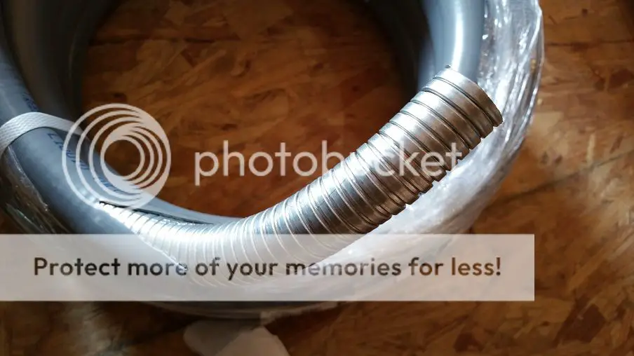

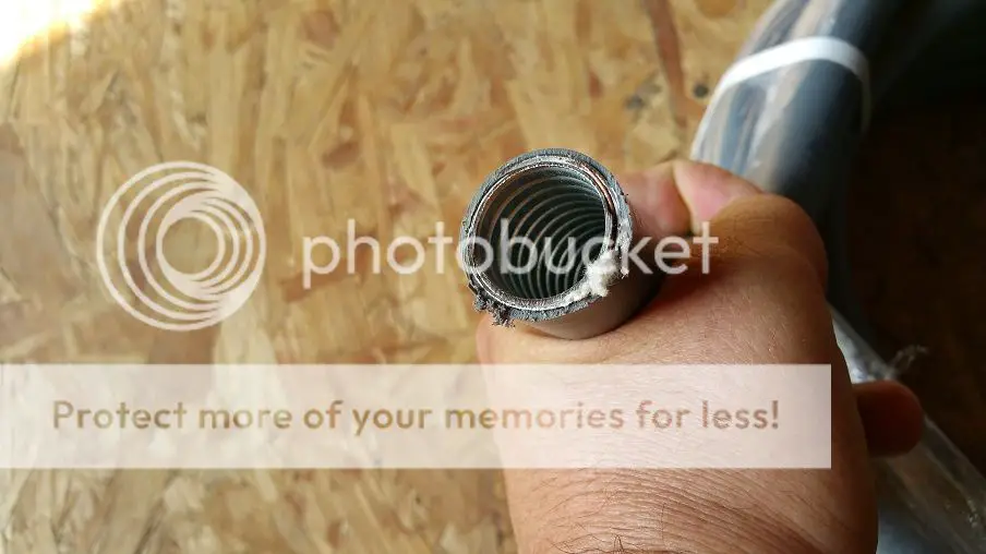

Here are just some quick pix I took of the Flexable liquid tite conduit, looks like this will work great for exhaust header pipe and then use the other techniques described in the last few posts to get the rest how ya want it.

In defense of my earlier comment about weathertite conduit let me explain. What you buy at Home Depot or any hardware store is not the same stuff used in industrial/commercial applications which DOES have a plastic or teflon inner lining which makes pulling wire through it easier that the less expensive stuff.
Motorbicycleracing is correct about it being metal on the inside diameter but the product I've used has the inner lining. It would not lend itself to exhaust use. Personally I've never purchased weathertite from a big box store but only electrical supply houses which sells a different grade of product.
I have seen the type you're talking about Tom and that is precisely why I never gave the stuff even a second thought for using as exhaust pipe, most of the flexable conduit Ive seen working as a Maintenance mechanic for a while and now being an extruder operator in a manufacturing setting was the PVC type that has no steel in it at all and as I said if it was the type with steel it also had a lining.
But, hey we can learn something new everyday sometimes and Im glad Neil shared this little tid bit, I may have noticed it eventually, but I wish I had known sooner, it would sure have saved me some time and trouble in the past.
As far as needing to defend your earlier comment Tom, that isnt needed at all, you were right when you spoke of the product you had in mind, un-be-knowings to you and myself there is a heaper product out there and it looks as though it will work as was told by Neil.
No one was wrong, just two different products and now we all know..... happy happy happy...!!!
