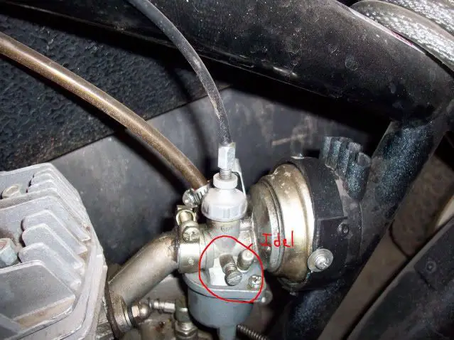

Two questions:1. Is the engine suppose to idle? Mine does not, it runs well but will not idle. 2. I saw a photo of a bike frame on this forum that has a suspension front and rear. I would like to build a bike like that one and where could I buy one. And where could I purchase disk brakes for it.

hi bill and welcome to the site. your bicycle motor carburetor has an idle screw and you should be able to get it to idle using that. i know i had to do a lot of fiddling with mine to get it right. glad to have you with us
Thanks for the info, I did not remember seeing an idle screw other than the mixture screw. Are they one in the same?

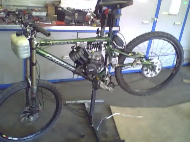

Also, where can I get a bike frame that has front and rear suspension like the one I saw in a post on the forum?

I live in the Oklahoma City metro in a city named Edmond. I have enjoyed the motorized bike thus far but the kit leaves much to be desired. I plan to build a bike with both front and rear suspension if someone will direct me to a source for a frame like the one I saw on the forum.

There is no mixture screw that Is the idle screw... run it in all the way then back out four and a half turns as a starting point.

Thanks for the info, I saw a frame on this forum with both a front and rear suspension now I cannot find it, any ideas? Turning the idle screw which way does what?

This is the idel screw....In to raise the idel....out to lower idel
To change the air/fuel mixture...you have to change the clip on the needle jet... You will have to pull your carb off and take it apart....Thier is a post somewhere here how to do it.
Is this the bike you are talking about ???

Thanks for the reply. The bike I am searching for is just a frame only and later had pic with rims.

http://motorbicycling.com/f25/ezrs-full-suspension-summer-project-1286.html
Ahhh, that's another easy rider the same as the first pic I posted. If I remember right, he spent a while looking for the right frame. I had a double suspension bike but I built mine.
Their is the link above, ask Easy Rider about the frame, I'm sure he would be more then happy to answer any questions you might have.
:ride2:
Thats it, thanks for taking the time to find it. It should make a great motorized bike.
