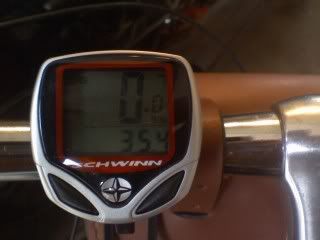

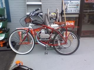

4th ride today. 2.5 hrs total and 32 miles. Picked up a lil power and speed. Not so you could feel it but by speedo. Did a fairly steep hill really well. She briefly did 34 MPH but may have been a hickup with the speedo as I could not repeat it but did 32/33 on flats no problem. Smooth as butter (on a saltine, lol) Have used about a qurter of a tank so far and am thinking I will be happy with the MPG. The Grubee gearbox is wearing in and sounds much different then when new. To be expected but sounds less mechanical then before. More of a whizzing sound then a solid cog on cog sound. Still very quite. The kill switch needs to be re soldered but am in no rush as I stink at soldering and have never had a kill switch last at all. (the dreaded kill-switch curse) Rewired the stock switch on the engine and is fine for now.
No bout a doubt it, my favorite MB of the lot of them.

Thanks Bill. I really like the way it looks with the roll bag up front. dunno, just gives it an old world sort of look. Some day, I really want to put them on this bike; Schwinn: 2009 Classic Seven Deluxe
Dang thing is $700. But man, it is purty. That much $, I should invest in Brooks.

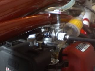

I did not know that was an option but wanted to keep the stock one any way when I did find out. I will post close ups of what I did. After the trial & error and the "got it bassackwards" stuff, it was amazingly easy to put the assembly together. total cost was 3 or 4 bucks worth of stuff and I used parts off the gear box. Only thing I bought was one spring. the rest came off an old bike rusting behind my shed.

Side note; 4th and fifth ride today. OH MAN, THIS THING IS AWESOME!!!!! I love all the MBs I have built, I really do. But am in love with this thing. 32 MPH, she humms happily along. No fuss, no muss. She starts first pull and vibes just enough to let you know she is ok and happy.
just hummm.
New bent seat post is awesome! Makes a big difference in ridding comfort. Baby at the hardware store.. Thanks again 2Door!!!!
Also breaking in very nicly. 35.4 MPH today and still smooth as butter.
This is the super fantabulos inline throttle spring return device. Really does work great. I used the clutch engager wire holder and a small arm that came with the gov on the GX. I just bought a spacer to cover the spring and work as a stop. Whole thing cost about 2 or 3 bucks. (I really did want to keep the Honda Carb and am glad I did now)

Thanks Fair! I mean that, you do some great work that gets me thunking. I am really proud of the inline springed return throttle. So dang simple, cheap and easy. Don't look like sheet but thats it's beauty, simple and works. Gonna get it pretty and right then market it with my kits (still in R&D)
