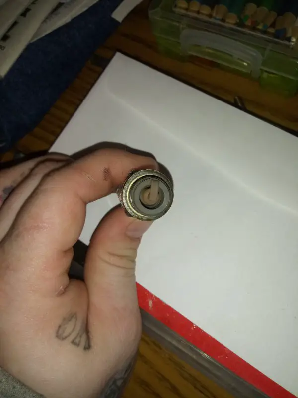

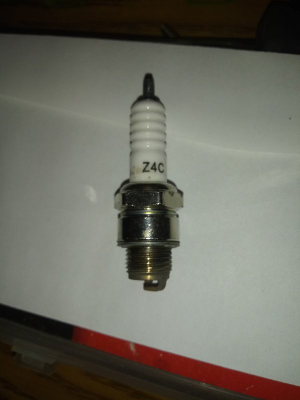

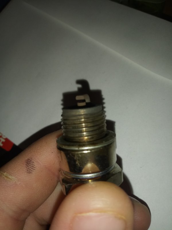

A weird pinging noise? What brand S/P do you have? Does the S/P have a #
How dose the S/P electrode color look, black, brown or gray, white
that's what she looks like it's a good color, that's about close to the color you want out right?
